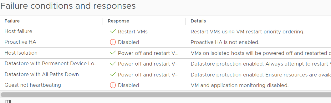

    Thanks for the reply!
    There was no incident reported and isolation is everything set to default there were no other parameters added.
    i don't see any alert under triggered alarm to acknowledge.

    You can disable and re-enable vSphere HA to get rid of this alert.
