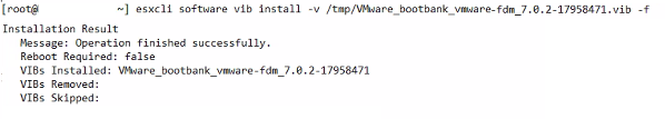

    - Copy the latest FDM VIB from VC to the ESXi host (/tmp folder or to some datastore)
    (sample file name from 7.0 environment - /etc/vmware-vpx/docRoot/vSphere-HA-depot/vib20/vmware-fdm/VMware_bootbank_vmware-fdm_7.0.2-17958471.vib)
    - Remove the old VIB version from ESXi host using command esxcli software vib remove -n vmware-fdm
    - Install the new FDM vib using command esxcli software vib install -v <vib full patch>
    Sample result:
    - Retry HA configuration
