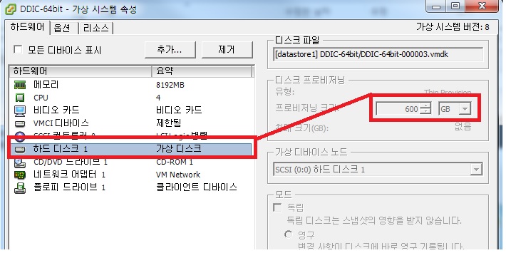

    As  you can see in the picture below, I have assigned 600Gigs for my guest OS (CentOS).

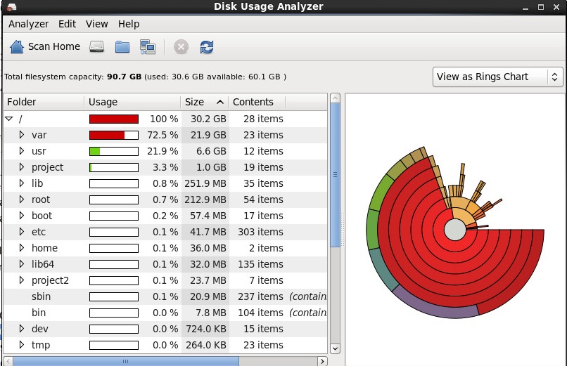

    But I have found that the OS actually is using only 90Gigs as seen in the picture below.
    Do you have any suggestion for this? Or any idea why this is in this way?

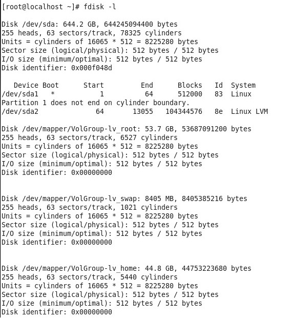

    Can you provide the output of fdisk -l of your CentOS guest ?
  • 3.  RE: Guest OS does not use entire disk space
    Posted Aug 04, 2014 12:46 PM
    Hello, Richardson.
    Here is the output of fdisk -l.
    Thank you very much for your help!!!!

    I see your 600GB disk is thin provisioned, so what you see is expected.
    This means that blocks are not allocated until needed.... See more here: VMware KB: Using thin provisioned disks with virtual machines

    kangjh0101, seems like your LVM is not using all the disk space, cause according with your print, the / logical volume have 53,7GB and /home 44,8GB... what you need to do is extend the logical volume inside your CentOS.
