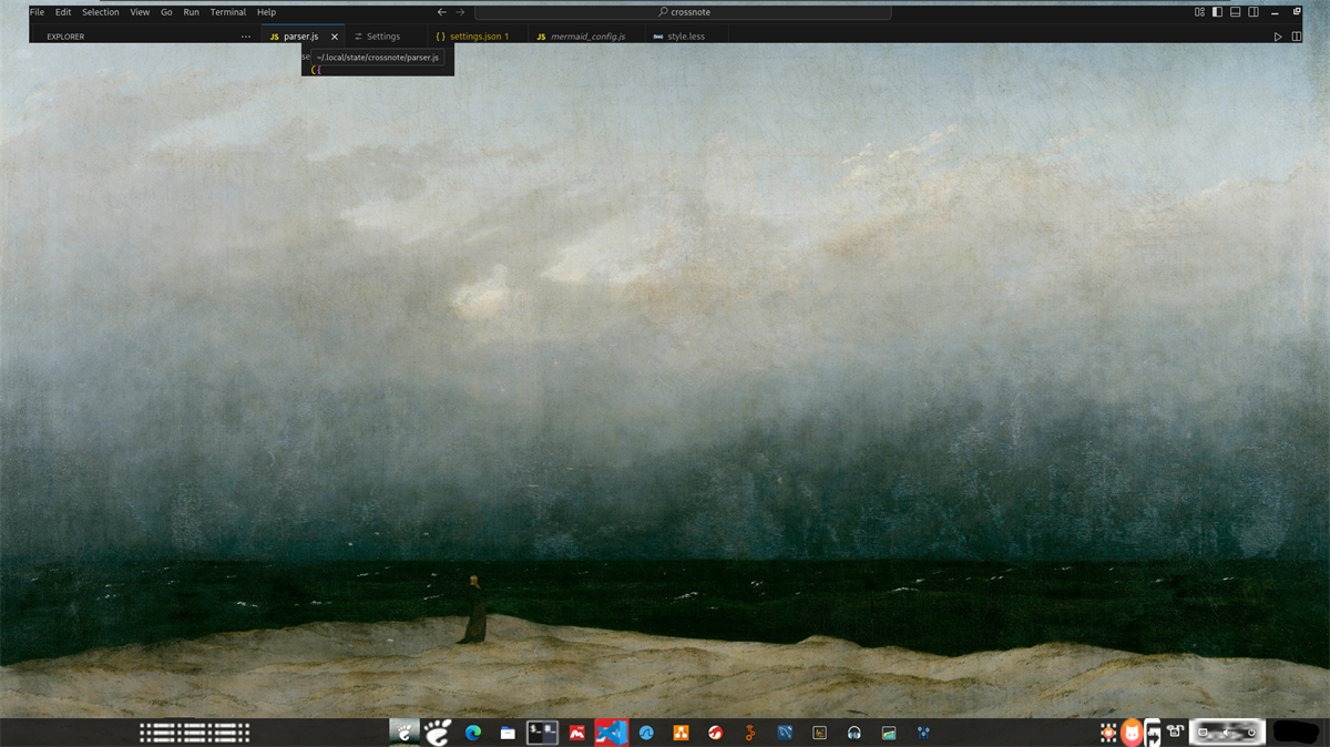

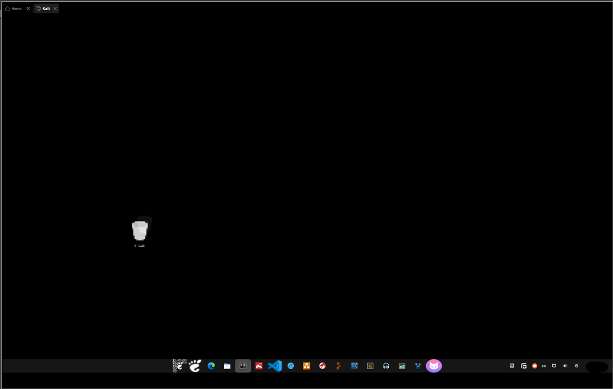

    Description:
    When "Accelerate 3D graphics" is enabled for a Kali Linux VM guest, its desktop environment (GNOME Wayland) becomes filled with graphical artifacts after the VM has been running continuously for around 20 hours on a Windows 11 host (physical machine). At this moment, the Kali Linux VM guest continues running, and the graphical interface can be restored by rebooting the VM.
    This issue does not usually occur during a short-term running Kali Linux VM guest, like 4 hours.
    This issue has persisted for at least six months and can be consistently reproduced on two different Windows 11 PCs with different hardware configurations.
