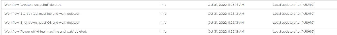

But we're finding that if we try to push a changed object to git, we start getting merge conflicts for objects we didn't select. We've also seen other behavior like a bunch of built-in workflows getting deleted during a Push. Not a pull, but while pushing.
