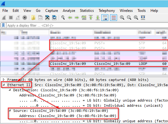

    Hi,
    I think this is quite unusual approach, as normally you can enable CDP/LLDP on your switch, and then identify physical switch name and port number in vSphere Client and get mac address from the switch.
    If you don't have any other possibilities I would try with
    1. Connect to host with putty.
    2.Replace vmnic0 with your nic number.  Run command : pktcap-uw --uplink vmnic0 -c 500 -o /tmp/test.pcap
    3. Connect to host with WinSCP and copy test.pcap file
    4. Open file in Wireshark
    5. Check STP or LOOP protocol

    Hi pragg12,
    sorry for my late replay. I had some bigger problems so I had to postpone this case here. It looks brillant and I'm sure this will help me. Hopefully I can go back to this in two days.
    When it worked I'll mark you're answer as correct one. Many, many thanks for this great solution!
