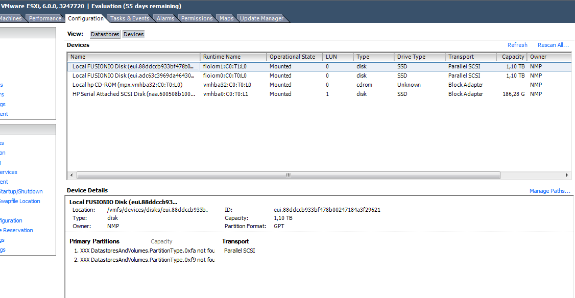

    Once you've done this, the ESXi 5.x drivers are functioning under ESXi 6.0 without any problems. I use the FusionIO drives as VSAN-cache (also as storage for this test)

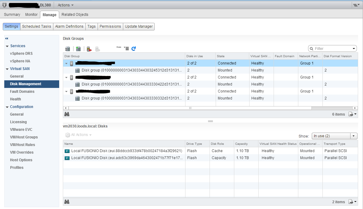

    The drives show up in ESXi like this:
    In the VSAN:
    So you can use your FusionIO drives in 6.0!
