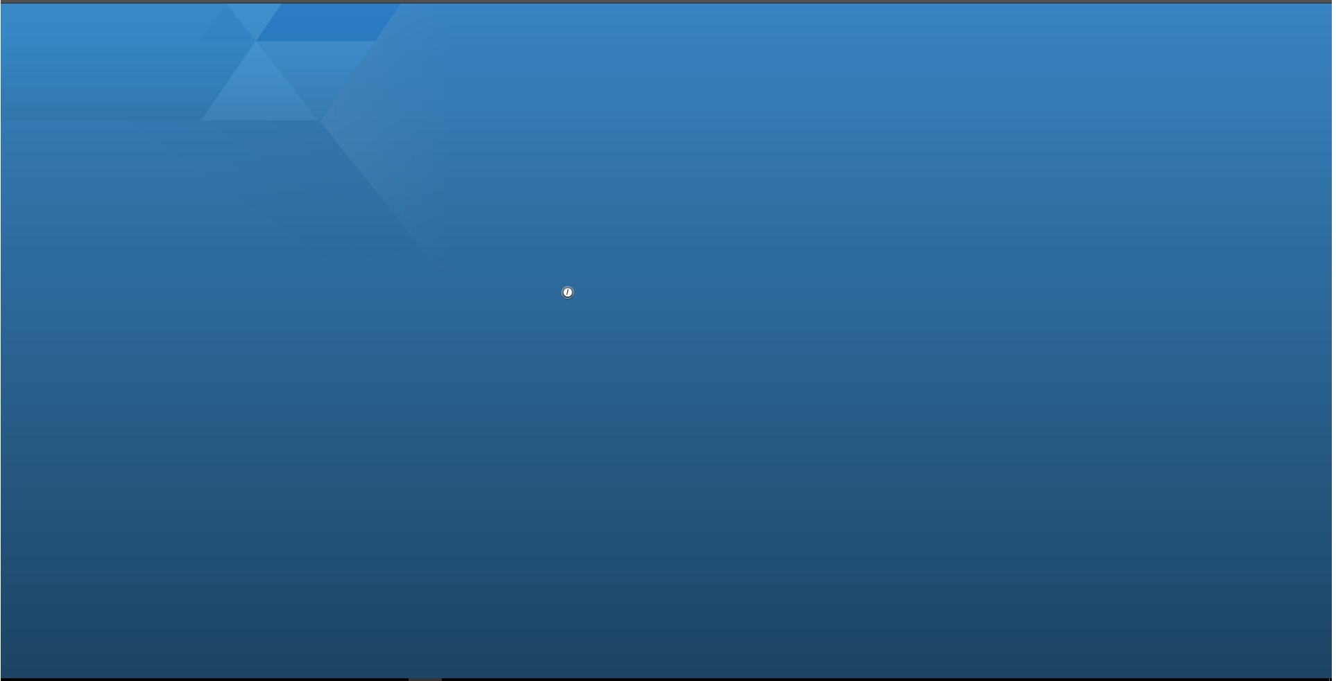

    Hi,
    I installed vcenter 6.5 on windows server 2016. HTLM5 based web client works but flash based web client does not open.
    I have an external SQL DB with data from previous vcenter 6.0. I can see my hosts and vm's from HTML5 client but i can't add my license key from HTML5 client. Because of this reason can't connect my hosts to new vcenter server. If i can somehow use flash based client, probably i can add my license key and connect my hosts to vcenter server. Is there anyone had this same problem?

  • 5.  RE: Flash Based Web Client Stuck on Blue Screen
    Posted Feb 18, 2018 09:07 PM
    Tried it right now and still same. Screenshot attached.
    This is the url: https://vcenterFDQN/vsphere-client/?csp
  • 6.  RE: Flash Based Web Client Stuck on Blue Screen
    Posted Feb 18, 2018 09:12 PM
    In chrome, have you whitelisted the address of your vCenter in the Flash settings?
  • 7.  RE: Flash Based Web Client Stuck on Blue Screen
    Posted Feb 18, 2018 09:16 PM
    Yes, i did.
  • 8.  RE: Flash Based Web Client Stuck on Blue Screen
    Posted Feb 18, 2018 09:23 PM
    Try the URL without ?csp at the end.
  • 9.  RE: Flash Based Web Client Stuck on Blue Screen
    Posted Feb 18, 2018 09:29 PM
    It is automatically completes to /?csp. Tried in incognito mode too.

  • 26.  RE: Flash Based Web Client Stuck on Blue Screen
    Posted Mar 01, 2018 02:04 PM
    Does this error appear when you try to login? or it appears constantly in the log?
  • 27.  RE: Flash Based Web Client Stuck on Blue Screen
    Posted Mar 01, 2018 02:41 PM
    Yes, it appears when i try to login from Flash Client.
  • 28.  RE: Flash Based Web Client Stuck on Blue Screen
    Posted Mar 01, 2018 03:04 PM
    To be honest, I don't know what can cause this error in your situation. Maybe a MS patch could break Web Client.
    If your environment isn't big I think that reinstall is the most quickest way to fix the issue. Also consider to move to VCSA.
