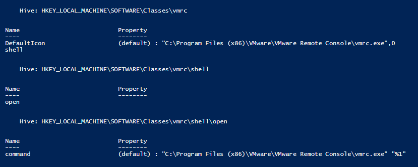

    I too experienced this issue, not only after installing Workstation 12.5, but also after updating it.  I found the following quick fix that starts working immediately.
    The following PowerShell commands will correct the issue.  If you are not comfortable with PowerShell, you can navigate to these paths in regedit.  NOTE: It is always best to backup the registry before making changes.
    Set-Item HKLM:\SOFTWARE\Classes\vmrc\DefaultIcon -Value '"C:\Program Files (x86)\VMware\VMware Remote Console\vmrc.exe",0'
    Set-Item HKLM:\SOFTWARE\Classes\vmrc\shell\open\command -Value '"C:\Program Files (x86)\VMware\VMware Remote Console\vmrc.exe" "%1"'
    After running the commands:
    If you launch a VMRC link, it will open in VMRC again and not Workstation - no restarts required.

    thank you csmith for the information.  I created a reg file using your information.  I thought some might find it useful so I am attaching it here.
    Here is what it contains if you can't download it.
    Windows Registry Editor Version 5.00
    [HKEY_LOCAL_MACHINE\SOFTWARE\Classes\vmrc]
    "UseOriginalUrlEncoding"=dword:00000001
    "URL Protocol"=""
    @="URL:VMware VMRC Protocol"
    [HKEY_LOCAL_MACHINE\SOFTWARE\Classes\vmrc\DefaultIcon]
    @="\"C:\\Program Files (x86)\\VMware\\VMware Remote Console\\vmrc.exe\",0"
    [HKEY_LOCAL_MACHINE\SOFTWARE\Classes\vmrc\shell]
    [HKEY_LOCAL_MACHINE\SOFTWARE\Classes\vmrc\shell\open]
    [HKEY_LOCAL_MACHINE\SOFTWARE\Classes\vmrc\shell\open\command]
    @="\"C:\\Program Files (x86)\\VMware\\VMware Remote Console\\vmrc.exe\" \"%1\""
