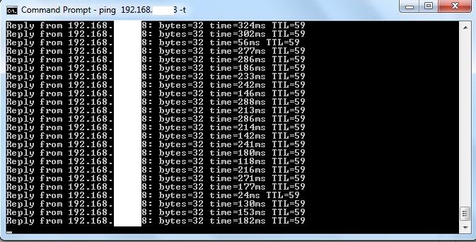

    hi guys,
    I got the same issues and problems with vsphere 6 FT in my lab and production environment running all 10 GB NICs. Even tried 1 vCPU VMs with the same result.
    you can see what we mean in this "how to" clip on youtube (watch the cmd box with the ping -t)
    https://www.youtube.com/watch?v=SyfFckgI26I
    opened up a case @ vmware but I think multi CPU FT is just not finished yet and should not be used in production.
