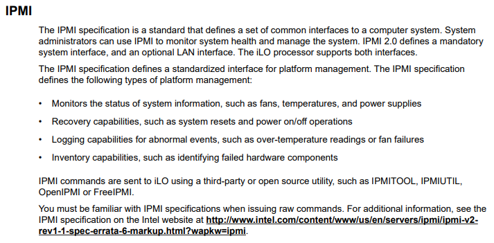

    I had a fan problem with my Dell servers, and I ended up using there software (IPMITool) to lower the speed manually, maybe HP has a software like that?

  • 14.  RE: fans at 100% !!! ESXi + HPE DL20 Gen10
    Posted Nov 05, 2019 10:37 AM
    You should also be able to use IPMITool on HPE servers:
