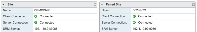

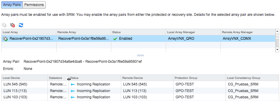

    Our team configure a SRM platform, configuration was ok but when running "Test Recovery Plan" we get error Failed to sync data on replica consistency group. Failed to create snapshot.
    All versions are correct based on compatibility matrix.
    SRA RecoverPoint 2.2.0.3
    ESXi v.6.0.0, 3620759
    vCenter v.6.0.0 Build 3634793
    SRM v.6.1 SRM Plugin Build 3884620
    RecoveryPoint v.4.1.2
    We tried modifying the parameter storage.commadTimeout=1200 (original is 300)
    Any suggestion will be OK.
