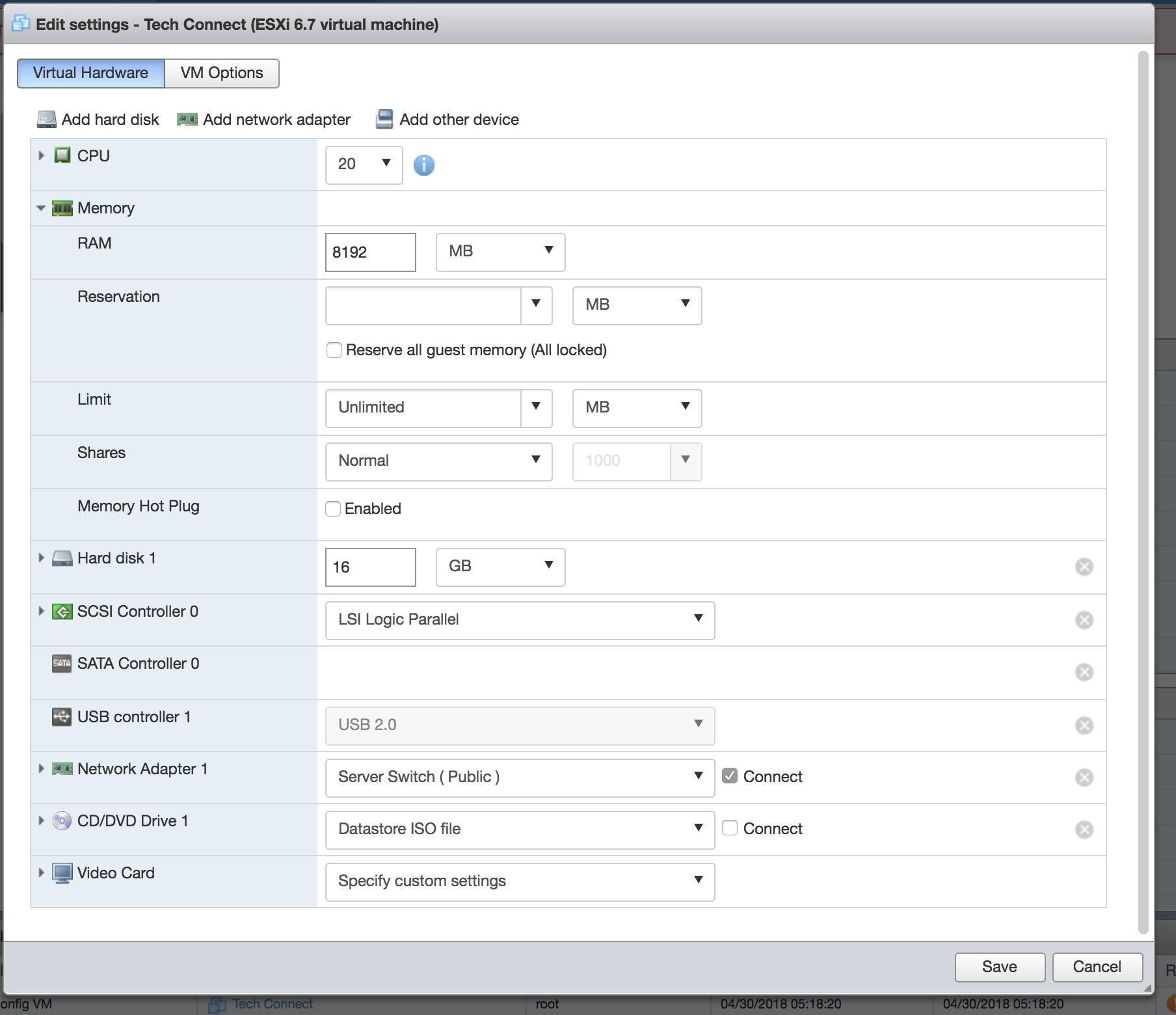

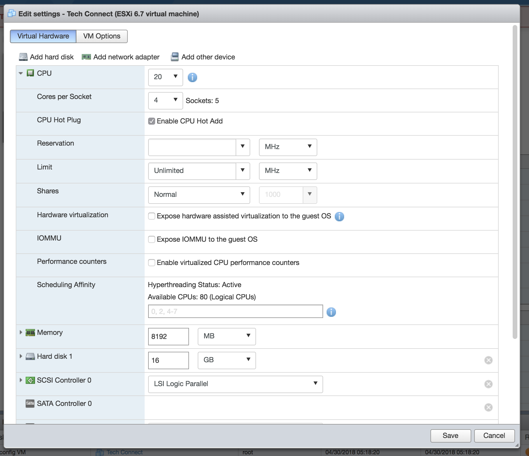

    This weekend the hard drive that ESXI 6.5 was loaded on it, died. I was unable to recover the configuration. So I got a usb stick and loaded esxi 6.7 on it. Added all of my vm's from the storage raid config, then I was able to boot all except the most important one "of course", I'm getting the error, "Failed to power on virtual machine Tech Connect. Unable to enumerate all disks​. Ive tried googling and i have found nothing related to my error. Attached is a screen shot of the complete error message.

    Can you show this VM's configuration and maybe attach the VMX plus log file?
