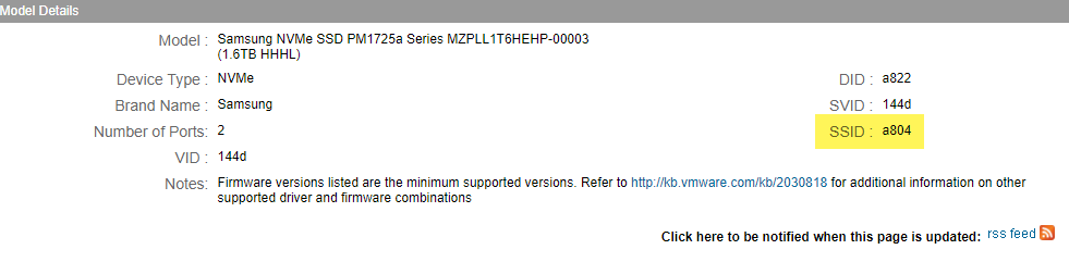

    In the future, please don't double post. It's probably throwing that message because your card is presenting a different SSID than what the HCL has in its database. Make sure you have the proper level of firmware and ESXi driver.

    VMware Compatibility Guide - I/O Device Search

    1. Does this SSD actually show up and work in ESXi?
    2. If answer to #1 is yes, the warning you're seeing, as I tried to explain, may be that the SSID of your card does not match what is on the HCL.

    [root@localhost:~] vmkchdev -l |grep vmhba3
    0000:04:00.0 144d:a822 144d:a812 vmkernel vmhba3
    Can this warning message be ignored? please confirm
    Yes, it shows SSD  and is working fine in ESXI server.
    Can you please tell me if we can ignore that warning message ?
  • 9.  RE: Failed to find IO Device 'NVMe SSD Controller
    Best Answer
    Posted Jan 04, 2019 05:37 PM
    Then yes, you can ignore the warning.
