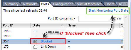

    3.  From Home > Inventory > Networking, Select your 1000v vDS in the left pane, and in the right pane select the Ports tab and review the State Column.  Scroll through and see if the VM in question is "blocked".  If so, click "Start Monitoring Port State" at the top right.  Often this will clear the issue.  If not proceed to step 4.

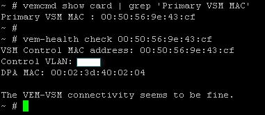

    5.  If you are seeing a port blocked in either step 3 or 4 above, then perform the following to confirm the health of the VEM to VSM communication:
        vemcmd show card | grep 'Primary VSM MAC'
         Using the MAC address returned from the above, run the following command to perform the health check:
        vem-health check <mac from above>
        Example:
    6.  If any errors are reported on the health check above, review as appropriate.  If the problem persists, perform a 'tail -fv /var/log/vmkernel.log' while attempting to connect the NIC or power the VM on.  Also consider tailing the vmware.log in the VM's directory.
