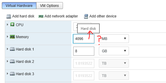

    1. While editing the settings for a VM, hovering the mouse over the Memory field indicates that the field is "Hard disk". See below.

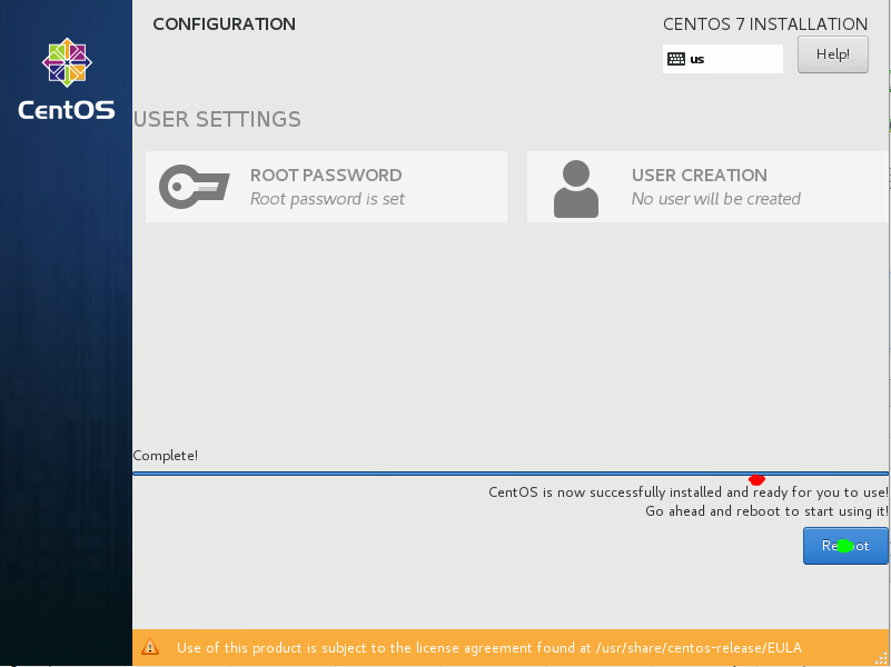

    2. While using a browser console, I had to "Reset to native resolution". I noticed that the scaling of the console was not honored after this. See below, the green dot is where I should be able to place my cursor to click the Reboot button, the red dot is where I have to place it (old location of Reboot button before native resolution reset).
