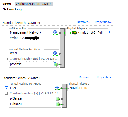

    I have a dedicated server which came with ESXI 6.5 pre-installed. There is just one IP dedicated to this, the management IP:  62.121.90.xx/27 from where I can log to ESXI. This instance had just one NIC installed at this IP. No NAT. I asked from my hosting provider to issue me a second IP which is of 83.159.147.XXX/26. What I want to do is the following:
    pfSense with two  network adapters one WAN where I can connect the internet and the second one I would like to use internally for Nating with other vms.
    I have created the following:
    Problem is that when I assign the new IP (83.159.147.XXX) to the WAN interface of pfSense I am not able to reach internet.

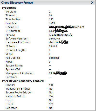

    Where is NICK connected?
    Click here, what shows?
  • 3.  RE: ESXI WAN IP
    Posted Mar 31, 2018 10:16 AM
    Thank you for your reply. Here is what it shows:
  • 4.  RE: ESXI WAN IP
    Posted Mar 31, 2018 10:31 AM
    You do not have VLANs on cisco.
    But pointed VLAN on Port Group "WAN"
    You need at least two VLANs.
    I think you should still read An Introduction to vSphere Networking: vSwitch & VLAN
    Although in your case it's easier to assign a management IP 83.159.147.XXX and VLAN ID 0 (WAN VLAN ID 0)

    Without a connection scheme (including physical equipment) and a detailed description, it is difficult to specifically answer something.
    It seems to me that your whole architecture is not right.
    For example, you still have not answered why you have a WAN VLAN ID 1. You yourself specified ID "1"?
    P.S.
    "But if we forget about the second IP for the moment, even with just one IP allocated to the ESXI management itself, how would I achieve my goal of having even a single machine connected to internet?"- No. Through the management network, or rather through the IP dedicated to the ESXi, you do not connect the VM.
    Virtual machine port group and VMkernel port can be in the same subnet. But at the same time, another IP address is needed for the VM.
    My advice is based only on guesswork.
    You can get one more IP 83.159.147.XXX/26 for VMkernel. And write VLAN ID 0 for WAN. But I'm not sure that without setting up a physical port it will all work.

    without a connection scheme, I have only guesswork that you do not make it clear.
    Did you try to put VLAN ID 0 on Vm Network (Virtual machine port group "WAN")?
