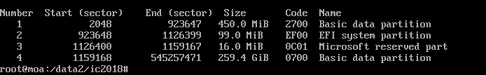

    Please look at this partitiontable - is this the Windows-bootdisk you need ?
    If yes - install Anydesk and call me / send a message via skype.
    Ulli

    Yes I am the partition table looks about right for the windows disk. I'll contact you on Skype shortly
