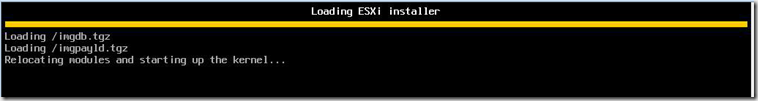

    When I boot, I see quite a bit of activity and finally it hangs on this screen:
    I stumbled across this error and a possible solution that mentioned hitting TAB while it is booting. That didn't do anything but it does show the option of hitting SHIFT-O that allows me to type"
    ignoreHeadless=TRUE”
    My setup isn't headless but adding this seems to allow it to start normally.
    I'm not getting any options whatsoever, though, it just appears to start.
    This BIOS screen if I stop it before it boots to the stick does detect the internal HD and the stick.

    Ok, I'm making progress.
    When I pressed Shift-O I saw the option
    "cdromBoot runweasel" which I was backing out and replacing with
    "ignoreHeadless=TRUE"
    I decided to try with both options in there. This time, it successfully booted and installed on the hard drive!
    On reboot, it continues to hang at the same spot unless I Shift-O and add the "ignoreHeadless=TRUE" after which it boots successfully into ESXi.
    So, now, I just need to figure out how to do this automatically.
    I'm guessing I need to modify the boot.ini file?

    Yes - looks like that.
    Find the boot.cfg file that is used on your system.
    To do that connect via WinSCP and find the partition that has the boot.cfg file side by side with all the modules that are loaded at boot-time.
    If you are sure you got the right one use the WinSCP embedded editor and edit the boot.cfg file.
    It has a line starting with
    kernelopt= installerDiskDumpSlotSize=2560
    Your version may have different options listed already. Add more options by using a space to separate them.
    In your case the result may look like
    kernelopt= installerDiskDumpSlotSize=2560 ignoreHeadless=TRUE
    dont add quotes or other fancy characters - dont use a Windows based editor to edit this file. The embedded editor of WinSCP is ideal for the job.
