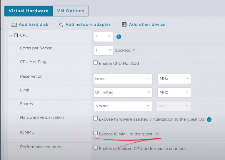

    1. Toggle PCIE device passthrough in the ESXI host
    2. Reboot the host
    3. Make sure VM is powered off.
    4. On the VM you are passing through, first make sure there are no snapshots- if any delete & consolidate all snapshots.  Note:  you can't have or use snapshots on a VM that has GPU passthrough setup.
    5. Disable/uncheck CPU features: IOMMU and hardware assisted virtualization passthrough
    6. Reserve memory in the VM (make sure the host has enough free at the time you power on the VM - eg if you have 16GB reserved, the but the host only has 10 Free right now, power on VM will fail).
    7. Edit VM hardware config and Add the GPU.
    8. power on VM and install the drivers.
    The basics are covered here in video form here: https://www.youtube.com/watch?v=aFXtUaFjiO4&t=3s
