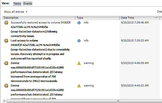

    I'm having this same issue on a few Cisco R210 and C240 UCS servers, all have local datastores using Megaraid controllers and running different versions of ESXi
    Cisco C240 - esxi 5.0 - no issues
    Cisco R210 - esxi 5.0 - disk access issue
    Cisco C240 - esxi 5.1 - disk access issue
    Cisco C220 - esxi 5.5 - no issues
    First
    Device
    naa.600605b005df73201951a1d33bc62893
    performance has deteriorated. I/O latency
    increased from average value of 708
    microseconds to 24612 microseconds.
    warning
    9/30/2015 4:46:09 AM
    10.2.42.23
    Lost access to volume
    54383f2f-62e7730b-ec74-4c4e3544bf5e
    (snap-0a1ec5ee-datastore1) due to connectivity
    issues. Recovery attempt is in progress and
    outcome will be reported shortly.
    info
    9/30/2015 7:39:33 AM
    Successfully restored access to volume 54383f2f-
    (snap-0a1ec5ee-datastore1) following
    connectivity issues.
    info
    9/30/2015 7:39:46 AM
    10.2.42.23
