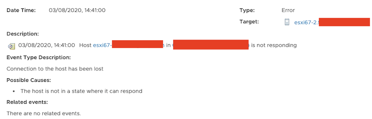

    I'm keep seeing the "not responding" message on VCenter randomly and I can't figure out what's going on. The VCenter seems to loose connection to the Hosts but they hosts are 100% healthy and works fine (VMs are also online and no issues).
    It happens randomly and it get back to normal randomly as well without touching anything (sometime after 10seconds, sometime after 15 mins and sometimes after hrs).
    I have searched through the logs on the host but I can't see anything related to this lost connection.
    Any specific log file that I can check? I checked hostd.log, vpxa.log and syslog.log on the hosts.
    I followed this KB (VMware Knowledge Base) but it's not an SSL Timeout issue.
    Tried to restart the hostd and vpxa on the hosts with no luck.
    In the VCenter the only error that I see is this but no much info to troubleshoot:
    Any Idea on what could be or where I can start to look to get more information on this?
