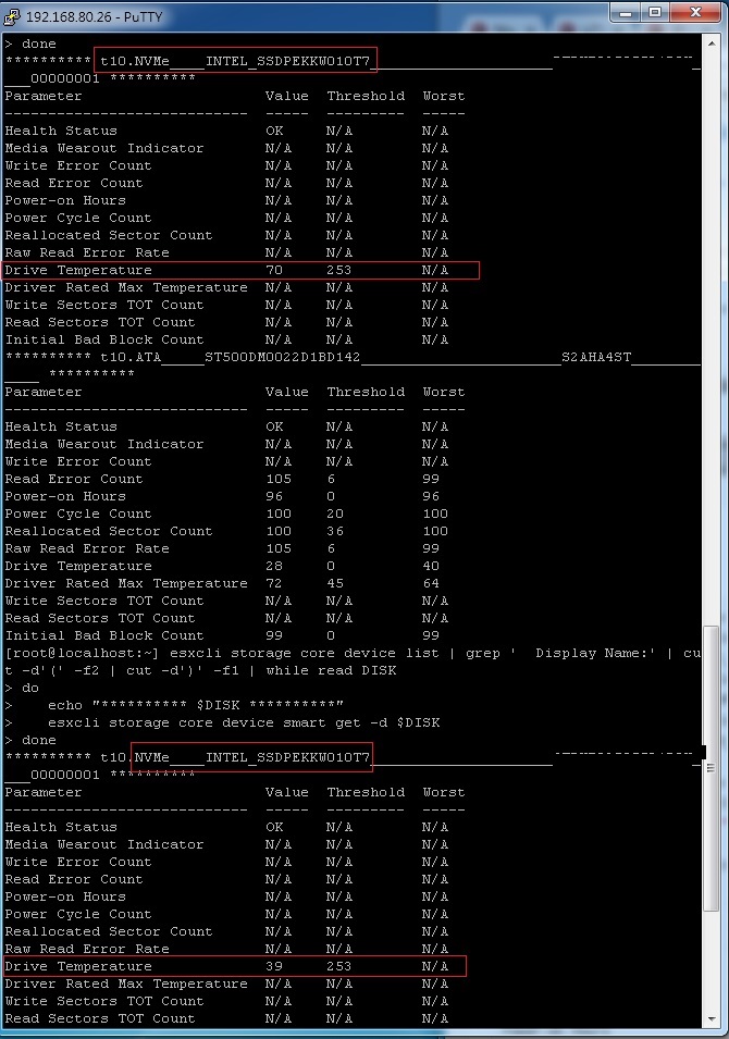

    my problem is fixed after attached a small heatsink on the controller
    i suggest that you better check your temperature by running following command:
    esxcli storage core device list | grep '  Display Name:' | cut -d'(' -f2 | cut -d')' -f1 | while read DISK
    do
       echo "********** $DISK **********"
       esxcli storage core device smart get -d $DISK
    done
  • 9.  RE: ESXi drops / loses VMFS-partition
    Posted Oct 02, 2017 10:32 PM
    Thanks ivanyeung510,
    It is definitely a heat related issue. I had the fan setting set to Optimal speed and I have had to put it on full speed to keep the drive working which unfortunately is significantly noiser. It looks like I will need to add a heatsink myself to allow for the quieter fan.
    I ran the command that you provided and the heat when I started to have issues was only 45 degrees which surprised me, I thought it would have had a higher threshold before I started to see the issues.
  • 10.  RE: ESXi drops / loses VMFS-partition
    Posted Oct 03, 2017 02:46 AM
    i have a experience on 70 degree
    after installing a small heatsink ,the maximum temperature <50
