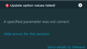

    On vSphere I changed the advanced setting ScratchConfig.ConfiguredScratchLocation to /tmp/scratch but anytime I try to set ScratchConfig.CurrentScratchLocation to /tmp/scratch or /tmp/scratch/.locker I get an error message.
    I briefly went through VMware Knowledge Base and it mentioned a restart was needed for that setting to be changed so I restarted. But when I went back to the hosts advanced settings those settings were reset back to the original datastore?
