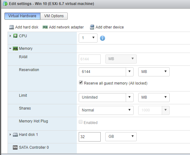

    I took a snapshot of the VM then went to VM hardware tab to add the card to the VM:
    I had to adjust the memory reservation etc as below:
    However, now it won't boot. I can't even get it to boot off install DVD into recovery mode! Nothing comes up on screen when I use the console, and the log has the following in it, but I have no idea where the error starts, and google has not been able to help me out:

    2018-08-26T18:58:27.028Z| vcpu-0| I125: SVGA: Unregistering MemSpace at 0xf0000000(0xf0000000) and 0xfb800000(0xfb800000)
    2018-08-26T18:58:27.029Z| vcpu-0| I125: SVGA: Registering IOSpace at 0x2040
    2018-08-26T18:58:27.029Z| vcpu-0| I125: SVGA: Registering MemSpace at 0xf0000000(0xf0000000) and 0xfb800000(0xfb800000)
    2018-08-26T18:58:28.517Z| vcpu-0| I125: AHCI-VMM:HBA reset issued on sata0.
    2018-08-26T18:58:30.297Z| vcpu-0| E105: PANIC: VERIFY bora/devices/pcipassthru/pciPassthru.c:948
    2018-08-26T18:58:33.104Z| vcpu-0| W115: A core file is available in "/vmfs/volumes/5aea2ac7-f8a56fc8-0045-d050994a8c62/Win 10/vmx-zdump.000"
    2018-08-26T18:58:33.104Z| mks| W115: Panic in progress... ungrabbing
    2018-08-26T18:58:33.104Z| mks| I125: MKS: Release starting (Panic)
    2018-08-26T18:58:33.104Z| mks| I125: MKS: Release finished (Panic)
    2018-08-26T18:58:33.152Z| vcpu-0| I125: Writing monitor file `vmmcores.gz`
    2018-08-26T18:58:33.156Z| vcpu-0| W115: Dumping core for vcpu-0
    2018-08-26T18:58:33.156Z| vcpu-0| I125: VMK Stack for vcpu 0 is at 0x451a0ba93000
    2018-08-26T18:58:33.156Z| vcpu-0| I125: Beginning monitor coredump
    2018-08-26T18:58:33.577Z| vcpu-0| I125: End monitor coredump
    2018-08-26T18:58:34.317Z| vcpu-0| I125: Printing loaded objects
    2018-08-26T18:58:34.317Z| vcpu-0| I125: [0xC5683D4000-0xC56953D044): /bin/vmx
    2018-08-26T18:58:34.317Z| vcpu-0| I125: [0xC5A9B7C000-0xC5A9B82630): /lib64/librt.so.1
    2018-08-26T18:58:34.317Z| vcpu-0| I125: [0xC5A9D84000-0xC5A9D85E90): /lib64/libdl.so.2
    2018-08-26T18:58:34.317Z| vcpu-0| I125: [0xC5A9F88000-0xC5AA21D364): /lib64/libcrypto.so.1.0.2
    2018-08-26T18:58:34.317Z| vcpu-0| I125: [0xC5AA44F000-0xC5AA4B834C): /lib64/libssl.so.1.0.2
    2018-08-26T18:58:34.317Z| vcpu-0| I125: [0xC5AA6C3000-0xC5AA7D737C): /lib64/libX11.so.6
    2018-08-26T18:58:34.317Z| vcpu-0| I125: [0xC5AA9DD000-0xC5AA9EC01C): /lib64/libXext.so.6
    2018-08-26T18:58:34.317Z| vcpu-0| I125: [0xC5AABEE000-0xC5AACD2341): /lib64/libstdc++.so.6
    2018-08-26T18:58:34.317Z| vcpu-0| I125: [0xC5AAEF1000-0xC5AAFECB94): /lib64/libm.so.6
    2018-08-26T18:58:34.317Z| vcpu-0| I125: [0xC5AB1EE000-0xC5AB202BC4): /lib64/libgcc_s.so.1
    2018-08-26T18:58:34.317Z| vcpu-0| I125: [0xC5AB405000-0xC5AB41C858): /lib64/libpthread.so.0
    2018-08-26T18:58:34.317Z| vcpu-0| I125: [0xC5AB622000-0xC5AB7C62E0): /lib64/libc.so.6
    2018-08-26T18:58:34.317Z| vcpu-0| I125: [0xC569959000-0xC5699789C0): /lib64/ld-linux-x86-64.so.2
    2018-08-26T18:58:34.317Z| vcpu-0| I125: [0xC5AB9D0000-0xC5AB9EA634): /lib64/libxcb.so.1
    2018-08-26T18:58:34.317Z| vcpu-0| I125: [0xC5ABBEC000-0xC5ABBED95C): /lib64/libXau.so.6
    2018-08-26T18:58:34.317Z| vcpu-0| I125: [0xC5ABE50000-0xC5ABFFF284): /usr/lib64/vmware/plugin/objLib/vsanObjBE.so
    2018-08-26T18:58:34.317Z| vcpu-0| I125: [0xC5AC2BF000-0xC5AC2D865C): /lib64/libz.so.1
    2018-08-26T18:58:34.317Z| vcpu-0| I125: [0xC5AC722000-0xC5AC72D758): /lib64/libnss_files.so.2
    2018-08-26T18:58:34.317Z| vcpu-0| I125: End printing loaded objects
    2018-08-26T18:58:34.317Z| vcpu-0| I125: Backtrace:
    2018-08-26T18:58:34.317Z| vcpu-0| I125: Backtrace[0] 000000c5ae64e450 rip=000000c568afcb47 rbx=000000c568afc640 rbp=000000c5ae64e470 r12=0000000000000000 r13=0000000000000001 r14=0000000000000800 r15=0000000000000001
    2018-08-26T18:58:34.317Z| vcpu-0| I125: Backtrace[1] 000000c5ae64e480 rip=000000c5685af090 rbx=000000c5ae64e4a0 rbp=000000c5ae64e980 r12=000000c5698033f0 r13=0000000000000001 r14=0000000000000800 r15=0000000000000001
    2018-08-26T18:58:34.317Z| vcpu-0| I125: Backtrace[2] 000000c5ae64e990 rip=000000c5686db107 rbx=000000c569e06750 rbp=000000c5ae64ea10 r12=0000000000000005 r13=0000000000000005 r14=0000000000000800 r15=0000000000000001
    2018-08-26T18:58:34.317Z| vcpu-0| I125: Backtrace[3] 000000c5ae64ea20 rip=000000c5686db18f rbx=0000000000000006 rbp=000000c5ae64ea80 r12=0000000000000000 r13=000000c569e06828 r14=000000c569e06750 r15=000000c569e06810
    2018-08-26T18:58:34.317Z| vcpu-0| I125: Backtrace[4] 000000c5ae64ea90 rip=000000c5686dbc8c rbx=0000000000000002 rbp=000000c5ae64eae0 r12=000000c569e06750 r13=0000000000000001 r14=000000c5ae64eb0c r15=000000c569e06800
    2018-08-26T18:58:34.317Z| vcpu-0| I125: Backtrace[5] 000000c5ae64eaf0 rip=000000c5686d5f8c rbx=0000000000000031 rbp=000000c5ae64eb40 r12=0000000000300004 r13=000000c5ad250020 r14=0000000000000000 r15=000000c569e06f80
    2018-08-26T18:58:34.317Z| vcpu-0| I125: Backtrace[6] 000000c5ae64eb50 rip=000000c5689b2781 rbx=000000c5698fdea0 rbp=000000c5ae64eb80 r12=000000c56960d880 r13=0000000000000164 r14=000000c569c870b0 r15=0000000000000000
    2018-08-26T18:58:34.317Z| vcpu-0| I125: Backtrace[7] 000000c5ae64eb90 rip=000000c5689d4216 rbx=000000000000012d rbp=000000c5ae64ebd0 r12=000000c5698033f0 r13=000000c5698f4fe0 r14=000000c5697cfd40 r15=0000000000000000
    2018-08-26T18:58:34.317Z| vcpu-0| I125: Backtrace[8] 000000c5ae64ebe0 rip=000000c5689b2891 rbx=0000000000000000 rbp=000000c5ae64ebf0 r12=000000c5ad2510e8 r13=000000c5ae64f9c0 r14=000000c569b79040 r15=0000000000000003
    2018-08-26T18:58:34.317Z| vcpu-0| I125: Backtrace[9] 000000c5ae64ec00 rip=000000c568a9dd17 rbx=000000c5ae64ec00 rbp=000000c5ae64ed20 r12=000000c569d5a1e0 r13=000000c5ae64f9c0 r14=000000c569b79040 r15=0000000000000003
    2018-08-26T18:58:34.317Z| vcpu-0| I125: Backtrace[10] 000000c5ae64ed30 rip=000000c5ab40d06b rbx=0000000000000000 rbp=0000000000000000 r12=0000032e27590b10 r13=000000c5ae64f9c0 r14=000000c569b79040 r15=0000000000000003
    2018-08-26T18:58:34.317Z| vcpu-0| I125: Backtrace[11] 000000c5ae64ee40 rip=000000c5ab70baed rbx=0000000000000000 rbp=0000000000000000 r12=0000032e27590b10 r13=000000c5ae64f9c0 r14=000000c569b79040 r15=0000000000000003
    2018-08-26T18:58:34.317Z| vcpu-0| I125: Backtrace[12] 000000c5ae64ee48 rip=0000000000000000 rbx=0000000000000000 rbp=0000000000000000 r12=0000032e27590b10 r13=000000c5ae64f9c0 r14=000000c569b79040 r15=0000000000000003
    2018-08-26T18:58:34.317Z| vcpu-0| I125: SymBacktrace[0] 000000c5ae64e450 rip=000000c568afcb47 in function (null) in object /bin/vmx loaded at 000000c5683d4000
    2018-08-26T18:58:34.317Z| vcpu-0| I125: SymBacktrace[1] 000000c5ae64e480 rip=000000c5685af090 in function (null) in object /bin/vmx loaded at 000000c5683d4000
    2018-08-26T18:58:34.317Z| vcpu-0| I125: SymBacktrace[2] 000000c5ae64e990 rip=000000c5686db107 in function (null) in object /bin/vmx loaded at 000000c5683d4000
    2018-08-26T18:58:34.317Z| vcpu-0| I125: SymBacktrace[3] 000000c5ae64ea20 rip=000000c5686db18f in function (null) in object /bin/vmx loaded at 000000c5683d4000
    2018-08-26T18:58:34.317Z| vcpu-0| I125: SymBacktrace[4] 000000c5ae64ea90 rip=000000c5686dbc8c in function (null) in object /bin/vmx loaded at 000000c5683d4000
    2018-08-26T18:58:34.317Z| vcpu-0| I125: SymBacktrace[5] 000000c5ae64eaf0 rip=000000c5686d5f8c in function (null) in object /bin/vmx loaded at 000000c5683d4000
    2018-08-26T18:58:34.317Z| vcpu-0| I125: SymBacktrace[6] 000000c5ae64eb50 rip=000000c5689b2781 in function (null) in object /bin/vmx loaded at 000000c5683d4000
    2018-08-26T18:58:34.317Z| vcpu-0| I125: SymBacktrace[7] 000000c5ae64eb90 rip=000000c5689d4216 in function (null) in object /bin/vmx loaded at 000000c5683d4000
    2018-08-26T18:58:34.317Z| vcpu-0| I125: SymBacktrace[8] 000000c5ae64ebe0 rip=000000c5689b2891 in function (null) in object /bin/vmx loaded at 000000c5683d4000
    2018-08-26T18:58:34.317Z| vcpu-0| I125: SymBacktrace[9] 000000c5ae64ec00 rip=000000c568a9dd17 in function (null) in object /bin/vmx loaded at 000000c5683d4000
    2018-08-26T18:58:34.317Z| vcpu-0| I125: SymBacktrace[10] 000000c5ae64ed30 rip=000000c5ab40d06b in function (null) in object /lib64/libpthread.so.0 loaded at 000000c5ab405000
    2018-08-26T18:58:34.317Z| vcpu-0| I125: SymBacktrace[11] 000000c5ae64ee40 rip=000000c5ab70baed in function clone in object /lib64/libc.so.6 loaded at 000000c5ab622000
    2018-08-26T18:58:34.317Z| vcpu-0| I125: SymBacktrace[12] 000000c5ae64ee48 rip=0000000000000000
    2018-08-26T18:58:34.317Z| vcpu-0| I125: Msg_Post: Error
    2018-08-26T18:58:34.317Z| vcpu-0| I125: [msg.log.error.unrecoverable] VMware ESX unrecoverable error: (vcpu-0)
    2018-08-26T18:58:34.317Z| vcpu-0| I125+ VERIFY bora/devices/pcipassthru/pciPassthru.c:948
    2018-08-26T18:58:34.317Z| vcpu-0| I125: [msg.panic.haveLog] A log file is available in "/vmfs/volumes/5aea2ac7-f8a56fc8-0045-d050994a8c62/Win 10/vmware.log".
    2018-08-26T18:58:34.317Z| vcpu-0| I125: [msg.panic.requestSupport.withoutLog] You can request support.
    2018-08-26T18:58:34.317Z| vcpu-0| I125: [msg.panic.requestSupport.vmSupport.vmx86]
    2018-08-26T18:58:34.317Z| vcpu-0| I125+ To collect data to submit to VMware technical support, run "vm-support".
    2018-08-26T18:58:34.317Z| vcpu-0| I125: [msg.panic.response] We will respond on the basis of your support entitlement.
    2018-08-26T18:58:34.317Z| vcpu-0| I125: ----------------------------------------
    2018-08-26T18:58:34.319Z| vcpu-0| I125: Exiting
    [Sorry - I can't see how to upload that as text code to make it smaller]
    So - can anyone help identify why this card is not working in passthrough mode and is preventing my VM from booting?! TIA.
