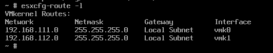

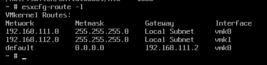

    I just tried to edit /etc/vmware/esx.conf and replaced the default gateway IP with the loopback IP (127.0.0.1) and then did a /sbin/auto-backup.sh to save changes. Then rebooted... Looks fine...
    Before edit:
    After Edit:
    /Rubeck

    Hi again..
    You proberly can, but I do not think that will make any difference if you have a static IP address for the host configured. The file is indeed backed up by auto-backup.sh, though.
    When editing and then running the /sbin/auto-backup.sh can you verify that the /bootbank/state.tgz is updated by extracting it and see if the esx.conf in there is indeed the one currently active on the host...?
    I just set up a new ESXi 5 VM which I've fully patched, and tried editing the esx.conf ones again replacing the default gateway with 127.0.0.1. Ran auto-abackup.sh and rebooted. It still works..  Im kind of puzzled to why it isn't working for you...
    /Rubeck
