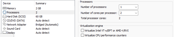

    Did you check whether VBS (Virtualization Based Security) is off. Here, on this forum, there are discussions describing how to disable the invisible virtualization layer in Windows. Hyper-V services are not enough. You VM's configuration has these two checkboxes checked:
    Unless you want to run Hyper-V inside the VM, you don't need these. Uncheck, then try again. If you need hardware virtualization features within the VM, you'll need to disable VBS.
