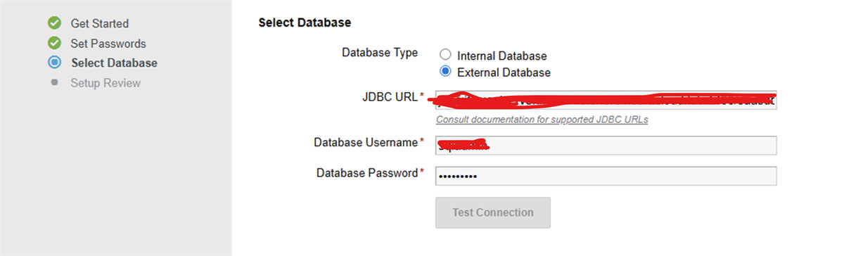

    Step 1 is done and everything is ok. But I can not find any cluster join option while setting up the second node! The only available option while connecting to the external DB is as below screen. Can you guide me where is join cluster option?
    Thanks in advance

    unfortunate a vIDM cluster can only be used with the embedded vPostgres database. If you really require to use an external database server then you'll need to use a single instance.
    I would however recommend to use the embedded vPostgres database either single node or cluster deployment.
    I do also recommend to use Aria Suite Lifecyle Manager to deploy your vIDM instance: Install VMware Workspace ONE Access in VMware Aria Suite Lifecycle

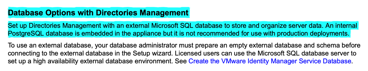

    But in VMware Identity guide 3.3 in broadcom there is a part named "Database Options with Directories Management". in this part it was mentioned that:
    Set up Directories Management with an external Microsoft SQL database to store and organize server data. An internal PostgreSQL database is embedded in the appliance but it is not recommended for use with production deployments.

    yes the documentation version 3.3.x for the Windows installation does mention that the internal PostgreSQL database is not recommended, we've  kept that part available for older versions. However only version 3.3.7 is currently supported and can only be deployed as an Appliance.
    Which you may have noticed the VMware Identity Manager documentation does not mention anything about the Appliance installation, only the Upgrade is documented.
    For deploying a clustered vIDM instance it is much simpler to use the deployment from Aria Suite Lifecyle Manager, as this will take care of the configuration of the cluster and also provides additional features for Postgres clustering, like the health check and auto-recovery:
    Scheduled health checks
    What's VMware Identity Manager Cluster Auto-Recovery in VMware Aria Suite Lifecycle 8.14
    As your VCF license is bundled for both products I would see no reason not to use Aria Suite Lifecyle Manager for the deployment.
