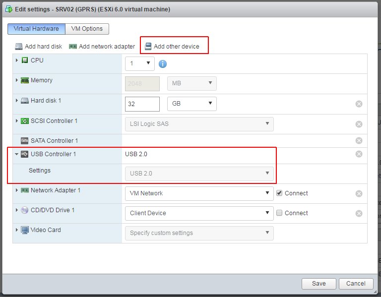

    How do I add e.g. the Serial Port USB device? I've tried "Add other device" in the Web Client but there is nothing.
    Am I doing it wrong or is something not working on my box?

    There should be an option when you click the "Add other device" to let you add the USB device like "USB device" in the pop up list.
    Could you paste your screenshot of the "Add other device"?
    And what physical port are you connecting your USB stick "Bus 001 Device 002: ID 0781:5567 SanDisk Corp. Cruzer Blade" to ? Is the physical port of your ESX host a 2.0 port or 3.0 port? And what's your USB stick version? is it a 2.0 or 3.0 version?  What type of Guest OS are you using?
    Also, please try to add a USB 3.0 controller to your VM to try  it again.

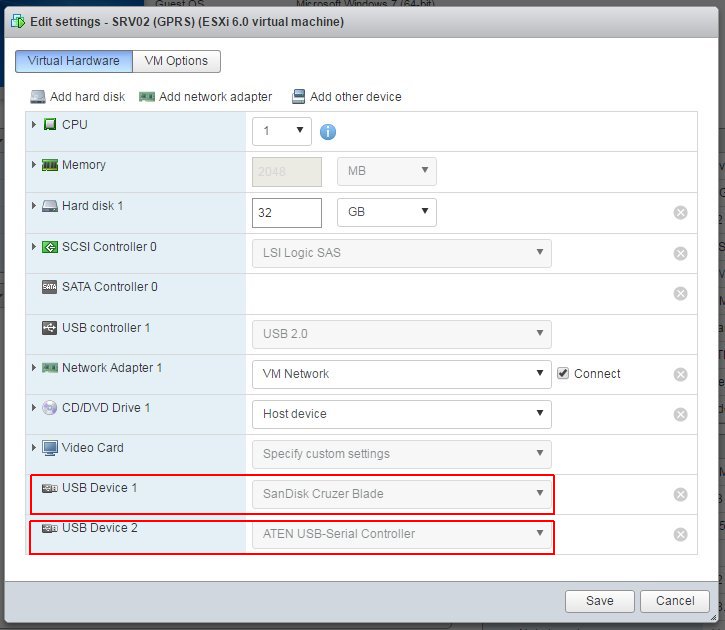

    Posted Sep 22, 2016 10:34 AM
    It seem I found a solution, I can now add USB devices :-)
    I updated the web-client to 1.9.1 (download at VMware flings)
    Happy it works, but sad about the solution: First of all it's very hard to find this update.....no link or info from within the web-client itself. Secondly it's a beta version.

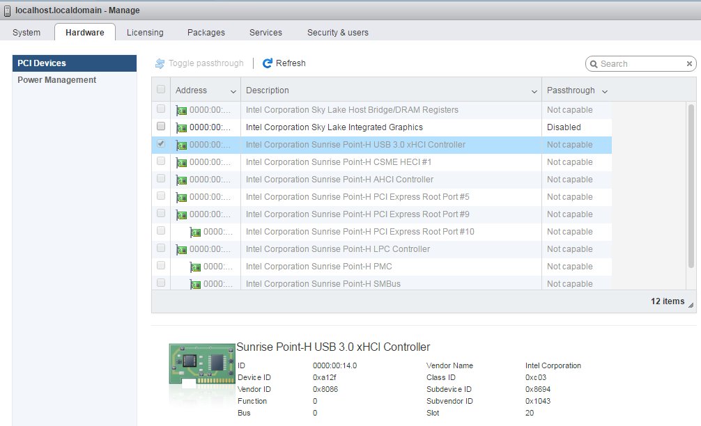

    On the host I see this USB3 device. It seems it doesn't support Passthrough. I assume it means it will not be possible to see this from the VMs.
    user9922, you appear to be confusing PCI passthrough and USB passthrough.  You are correct that passthrough of a USB 3.0 host controller as a PCI device is not supported.  This is true for any host controller or hub.  USB end devices can be passed through.  In your case all of your USB devices appear to be attached to USB 2.0 ports.  To passthrough a specific USB 3.0 device other than a hub or host controller please try the following:
    1) Add a virtual USB 3.0 host controller to your VM.  This is a virtual device just like the USB 1.1 and 2.0 host controllers that you already have.
    2) Ensure that the USB 3.0 device is attached to a USB 3.0 port (i.e., a blue one)
    From your original lsusb output the USB drivers are reporting that all devices are on a physical USB 2.0 bus.  The "root hub" is in fact the host controller.
