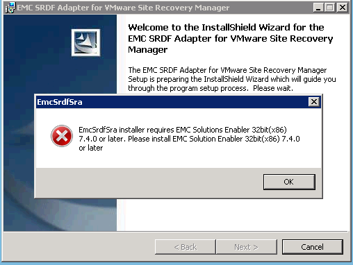

    I was then given this and told to install once the top two where installed:
    emc-vsi-sra-5.3.0-vmware-vsphere-WINDOWS-x86
    But of course it doesnt work and returns message which is attached.

    Next error message is attached as EMC SRDF Error, it mentions it requires EMC Solutions enabler 32bit 7.4.0 or later.

    Yeah you need Solutions Enabler installed locally on the SRM server in order for the SRDF SRA to communicate with the VMAX array. You can download Solutions Enabler on the support.emc.com website. Make sure you download the 32-bit version of Solutions Enabler (regardless to the architecture of the SRM server itself) Here is a direct link to the correct version to help:
    https://download.emc.com/downloads/DL46940_se7600-WINDOWS-x86.exe.exe
    Have you downloaded and read my Techbook for using SRDF with SRM? The install and configure chapter should make this a lot easier. You need to make sure you have Solutions Enabler servers configured on both sides etc. and this goes through all of that:
    http://www.emc.com/collateral/software/technical-documentation/h10553-sra-vmware-5-0-tb.pdf

    That you so much for the help! Finally got it all installed and working.

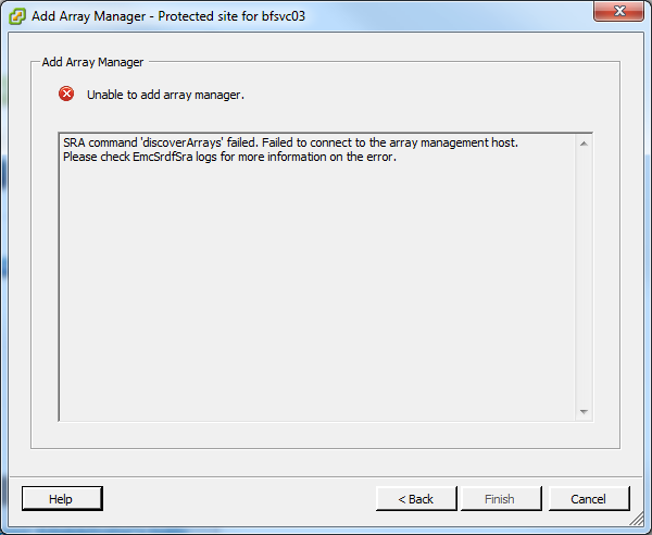

    But if you dont mind helping me with the next error.
    I followed your document (thanks for that btw) and started to create the array manager. I entered the local symAPI server name and the remote symAPI server name.
    But it returns with the following error.
    Something else to note is that the local symAPi and remote are vritual servers running on a standalone esx box. The 2 servers are windows 2008 and I added the SRMservice account as local admins just to make sure it wasnt that.
    Where can i find the logs to check them for more detail?
  • 8.  RE: EMC SRDF adapter
    Best Answer
    Posted May 30, 2013 10:32 PM
    You would need to look at the SRA log to find what the actual issue is. the log is in C:\Program Data\VMware\Site Recovery Manager\SRAs\EMC Symmetrix. I would suspect either the storsrvd daemon isnt configured properly or doesnt have the correct gatekeepers.
