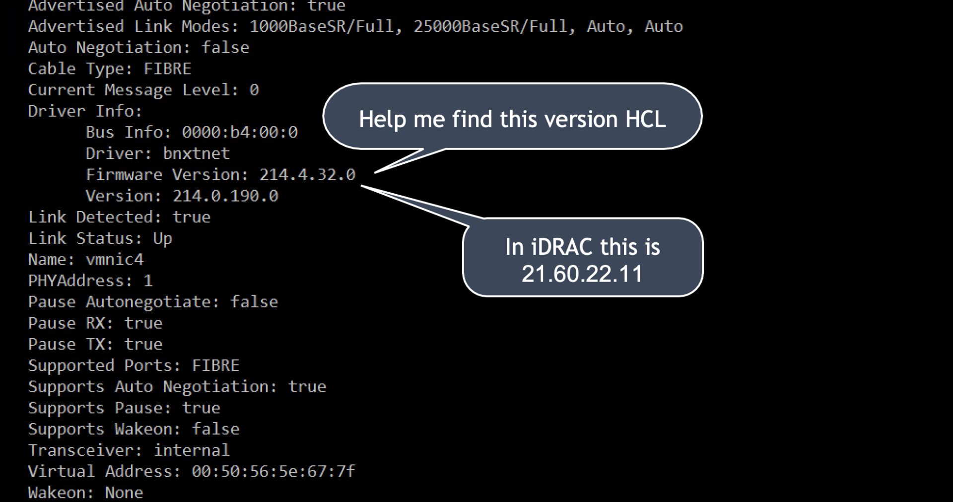

    In fact the firmware number do not even match with the firmware reported by Dell. This is worst thing.
    Well, i understand but its not knew (at least for me because i have to deal with it on a daily basis).  The repository (catalog) is only updated every few weeks/month but new FW releaes comes every "day" and are visible under the Server Model or better when using your Service Tag of your device for search on dell.com/support.

  • 9.  RE: Driver at VMware site and Firmware at Dell site ;)
    Posted Jul 02, 2020 07:51 AM
    I spend my time i finding 214.4.32.0. My GSS engineer was trying to give super explanation how they have moved the dots and took no responsibility about this data. Even though it is on their website. This firmware version is not there on Vmware website. This is on dell website and you see only on iDRAC on via esxcli.

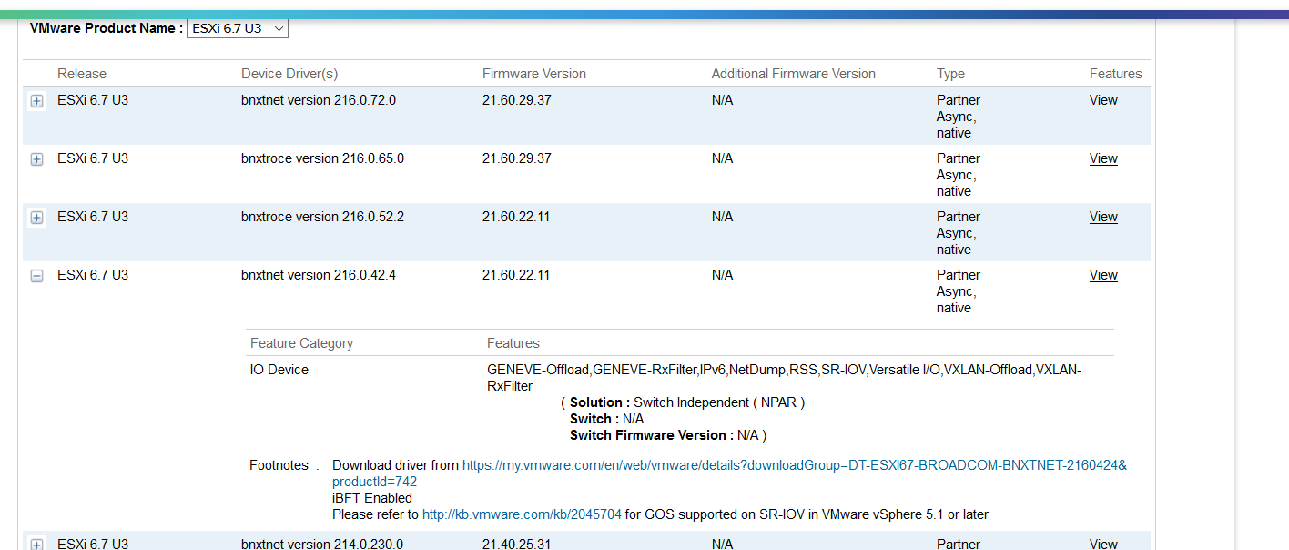

  • 14.  RE: Driver at VMware site and Firmware at Dell site ;)
    Posted Jul 02, 2020 06:47 AM
    I doubt VMware is testing all the driver and firmware version combinations for each IO device. Even the note on HCL states "Firmware versions listed are the minimum supported versions". Moreover, the HCL does not always list the FW version of lot of ethernet controllers (refer the attachment).
    By relying on Dell FW ISO, we are not completely in uncharted waters. As the expectation is Dell has tested and certified the Firmwares for the operating systems listed in their support release document.
    Again this is not an ideal way and Dell should seriously consider publishing a supported driver and firmware matrix with each (point) update to ESXi or Firmware repository.

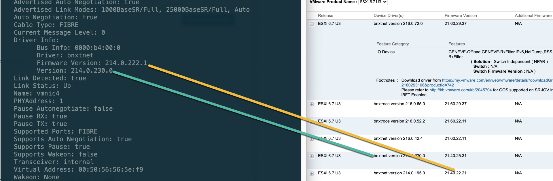

  • 16.  RE: Driver at VMware site and Firmware at Dell site ;)
    Posted Jul 02, 2020 11:22 AM
    Just for others to take lessons from this.
    Joreg you also mentioned this.
    I have built the ESXi 6.7 host using Dell ISO
    Green line -Driver version, Yellow line Firmware version.
    By default/using ISO CD combination is not matching.
    Joreg, I have already have to report. Thanks a lot. Hope others learn from this thread.
