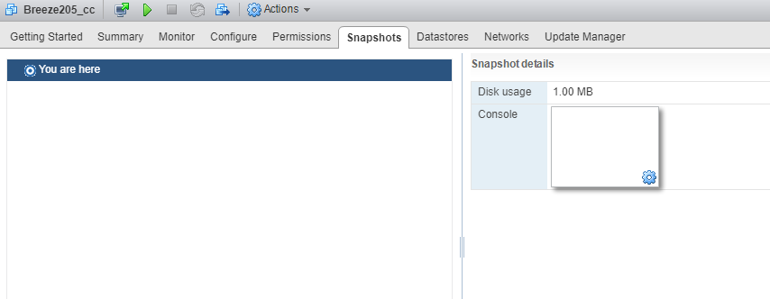

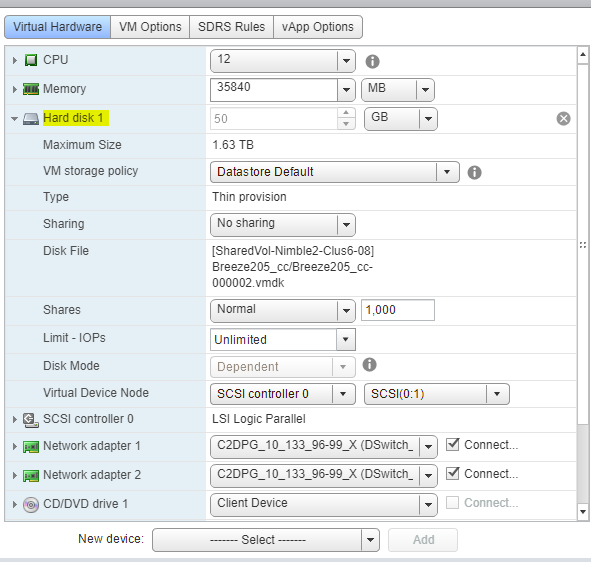

    vSphere 6.7 virtual machine disk is showing grayed out, I have deleted snapshot of that VM, but still the issue, screenshot is below
    Please help me on this.
  • 2.  RE: disk grayed out
    Posted Jan 16, 2020 11:02 AM
    the filename of the vmdk indicates that the vm is running on snapshot.
    try to consolidate
  • 3.  RE: disk grayed out
    Posted Jan 16, 2020 11:05 AM
    Hi,
    the -000 in the disk name indicates that you have a Snapshop. You must first delete the Snapshop and then allow you not to see it in gray. When there are SnapShops the disk cannot be expanded, for this reason it is displayed in gray.

  • 4.  RE: disk grayed out
    Posted Jan 17, 2020 06:07 AM
    As per above screenshot, there is no snapshot, but still the issue i am facing.
  • 5.  RE: disk grayed out
    Posted Jan 17, 2020 08:08 AM
    yes - but deleting the snapshot was not successful.
    please rightclick the machine, then "snapshots->consolidate disks". this action merges the snapshot to the vmdk. after this you sould be able to manage the vm
  • 6.  RE: disk grayed out
    Posted Jan 17, 2020 09:13 AM
    I tried the same but same issue.
  • 7.  RE: disk grayed out
    Posted Jan 17, 2020 10:07 AM
    Hi,
    In this post it was solved by creating a SnapShot and removing it later. After this operation the option was no longer grayed out.
    In the past, did this VM have a SnapShot? which may have caused the problem the moment it was removed.
    ARomeo
    https://kb.vmware.com/s/article/2048748
  • 8.  RE: disk grayed out
    Posted Jan 17, 2020 02:36 PM
    Glad it's working, in the event consolidation or snapshotting to remove again does not work, cloning the VM also merges all disks.
