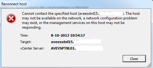

    No every attempt to connect using, ssh or the vsphere client doesnt work. And this is the error.

    Posted Oct 08, 2013 08:45 AM
    What error does it give when you try to connect it again to vcenter?
