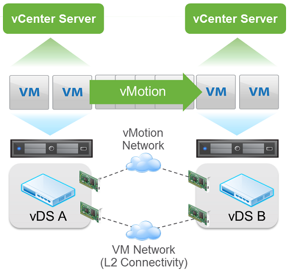

    Cross vCenter - migrate virtual machines between vCenter Server instances.
    Long Distance - migrate virtual machines over long distances (requirements: A RTT (round-trip time) latency of 150 milliseconds or less, between hosts)
    The cross vCenter and long distance vMotion features require an Enterprise Plus license.
    without aEnterprise Plus license, you can migrate the VM only within one vСenter, - within the same site. With a license, we can migrate VM between different data centers.

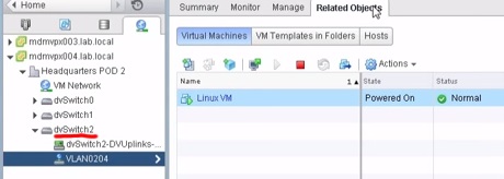

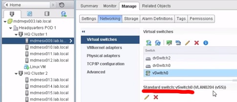

  • 14.  RE: Difference between 2 type of vmotions
    Posted Apr 02, 2018 09:12 AM
    before migration:
    after migration:
    cross vcenter vmotion AND cross vswitch vmotion can work together.
