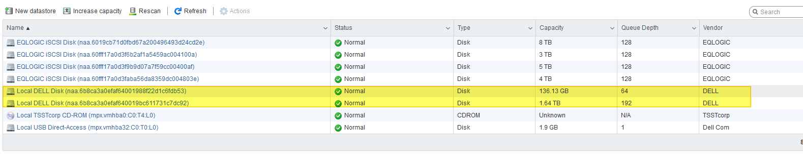

    hi,
    I'm newbie with vmware and have installed my first server
    its a HP with Raid1 after installing ESXi 6 U3 I saw that devices status is Normal, Degraded
    what means that? thanks.

    CIao
    It looks like a RAID level problem.
    From the ILO or the RAID console (at the BIOS level) are you having errors?
    Is RAID 1 control level configured? In theory, the volume created by the RAID should appear in the screenshot you attached. (Do not consider that in my image we speak of DELL volumes)
    fabio1975_0-1632397833085.pngInstead you see the two individual disks

    hi,
    no there are no error in iLO or HP array utility... the disks are all good, also the raid battery.
    I found this thread:
    https://communities.vmware.com/t5/ESXi-Discussions/Disks-degraded-in-ESXi/m-p/1404450
    with this reply:
    ____________
    We had opened a case with both HP and VMWARE. HP replied as follows:
    This field for the device is specifically reserved for indicating the path status of the device. If  there is only one path to the target then the status is "degraded".
    The host client is showing an extended information in case of New Server as ‘Normal, Degraded’ instead of just ‘Normal’.
    This does not have any effect on the functioning of the LUN.
    VMWARE said that because this is counted as remote disk so it expects two paths to it, if not found it will put it as degraded. Now to resolve this we need to tag this as local disk using the following procedure through SSH. But if you have vCenter, you can simply right click the device and click on `Mark as Local`. If no vCenter use the following procedure:
    esxcli storage nmp satp rule add -s VMW_SATP_LOCAL --device diskid --option="enable_local"     (replace the diskid with the disk identifier)
    esxcli storage core claiming reclaim -d diskid   (replace the diskid with the disk identifier)
    esxcli storage core claimrule load
    esxcli storage core claimrule run
    This has worked for me and all my local disks are showing as Normal now and `Status:ON`. The `Local` field is reading as true.
    Let me know if you need further help.
    ______________
    Can I run this commands?
    thanks

    I found this in an other tread and run it and can confirm that all status are correct:
    [root@ESXiTEST:/opt/smartstorageadmin/ssacli/bin] ./ssacli ctrl all show status
    Smart Array P410i in Slot 0 (Embedded)
    Controller Status: OK
    Cache Status: OK
    Battery/Capacitor Status: OK
    when I get this ... is it installed or not? to you thing I must install it ?

    nice link thanks. status all OK.
    ./ssacli ctrl slot=0 pd all show status
    physicaldrive 1I:1:1 (port 1I:box 1:bay 1, 146 GB): OK
    physicaldrive 1I:1:2 (port 1I:box 1:bay 2, 146 GB): OK
    physicaldrive 1I:1:3 (port 1I:box 1:bay 3, 146 GB, spare): OK
    physicaldrive 2I:1:6 (port 2I:box 1:bay 6, 1 TB): OK
    physicaldrive 2I:1:7 (port 2I:box 1:bay 7, 1 TB): OK
    physicaldrive 2I:1:8 (port 2I:box 1:bay 8, 1 TB): OK
    What version of VMware vSphere (indicate build) do you have. Do you have vcenter Server, what version (Build).
    You may need to update the ESXi host or the driver you are using.
    do you mean:
    Version: 6.0.0 Update 3 (Build 13635687)
    its the free Edition...
    i've taken this edition because this is supported by hp with my old g7 server
    it's possible to update this edition?
    thank you.

    for your information - Update to latest Patch was successful
    and the Normal, Degraded mode is now "Normal" so its now perfect.
    thank you for your help!
