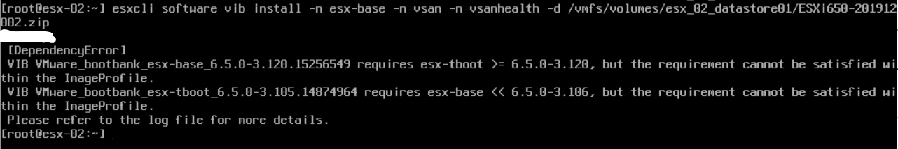

    I got 'DepencencyError' when applying a new patch downloaded from VMware patch list.
    Can anyone help?

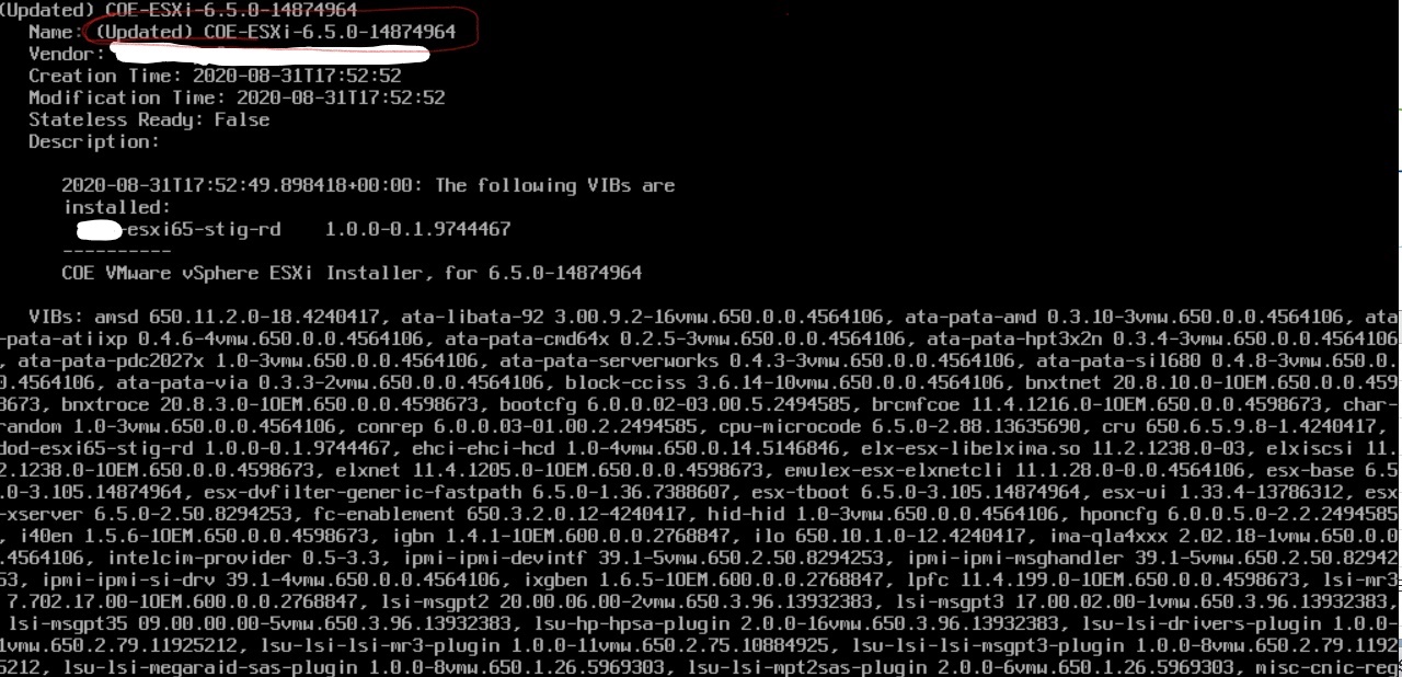

    Unfortunately our existing install is not a standard vendor one - we tweaked (customized)  the installer so the profile names are different
    Here is 'esxcli software profile get'

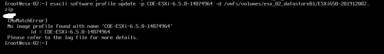

    Then update error (problem to match the customized name)

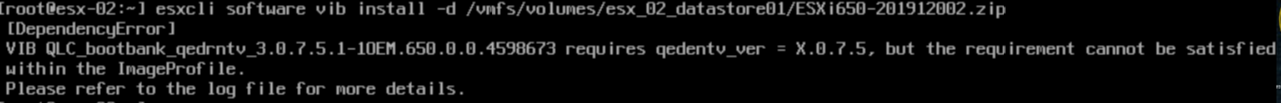

    Then I tried the 2nd way (VIB install) from the KB and got DependencyError
  • 6.  RE: Dependency error on patching with 'esxcli software vib' command
    Posted Sep 03, 2020 03:55 PM
    You have made a mistake, you have used image profile that installed on your ESXi host. Get image profile from the zip file and then update image profile. review the shared commands again.
