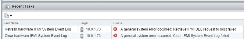

    I have a Dell R520 and a Dell R730 with Enterprise iDrac cards.  I'm running VMware 6.5U1 on both servers.  Servers have been up about 14 days and I just started getting an error in vCenter "A general system error occurred: Retrieve IPMI SEL request to host failed.".  Nothing has changed in my configuration that caused this.

    I tried KB 1033725 when I had the error, but even trying to clear the logs generated an error.

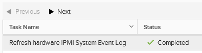

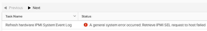

    "A general system error occurred: Retrieve IPMI SEL request to host failed" - looks like this has been resolved in the latest update of ESXi 6.5 (build 7967591).
    I've done upgrade using DellEMC-ESXi-6.5U1-7967591-A10 ISO (VMware ESXi 6.5 U1 Driver Details | Dell Australia), and now it works as expected:
    Previously, with DellEMC-ESXi-6.5U1-7388607-A07 it was still generating an error message:
    Hope this information helps.
