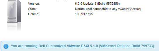

    I have a Dell PowerEdge R620
    Vsphere states that "You are running Dell Customized VMWare ESXi 5.1.0 (VMKernel Release Build 799733)"
    However, it also states that my Vmware ESXI is Version:6.0.0 Update 3 (Build 5572656)
    I tried to update to the latest VMWare 6.5 version, but I receive errors during the install.
    Question 1; How can I be running both a Dell ESXi and a VMWare ESXi?
    Question 2: What do I need to do to get the latest 6.5 version installed?

    You're currently running ESXi 6.0, but this host was originally installed via a Dell-customized ESXi 5.1 image.
    As for the errors you encountered, we need more information about what messages were displayed, how you attempted the upgrade, what commands you used, etc.

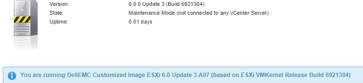

    Up[date:
    I was able to update to the Dell version 6.0 ESXi
    VMware-VMvisor-Installer-6.0.0.update03-6921384.x86_64-DellEMC_Customized_A07.zip
    Now, when I try to update to 6.5, I only have 4 errors, rather than the dozen I had before:
