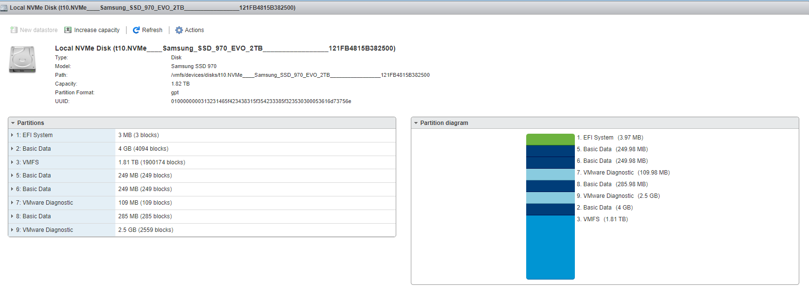

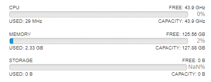

    Hi - not very experience at all with ESXi.  Running 6.7.0 (Build 8169922).
    Had a power cut last night and now the datastore isn't accessible.
    It look like its recognising the drive here but then its showing as 0 bytes/free space on other parts.
    None of my VMs are accessible but the VM list is showing 32 VMs..

    Check wether the 1.8tb vmfs partition still has the vmfs-magic number d0 0d.
    Use hexdump -C againstpartition 3.

    hexdump -C /dev/disks/naa-number:3 >> /tmp/hex.txt
    run that for a few seconds and  then show the first few lines.
    Ulli

    Doesnt work..
    stalls for a few seconds and returns:
    hexdump: /dev/disks/t10.NVMe____Samsung_SSD_970_EVO_2TB_________________121FB4815B382500:3: Input/output error

    I/O error before the vmfs magic number ? - sorry this means :
    A: you declare defeat here
    B: you must switch to a Linux LiveCD fr further troubleshooting
    Next step: find out which area is blocked by the I/O error ...f
    If only the range from 1 mB offset to 21 mB offset is damaged the datastore may still be repairable..
    Ulli
