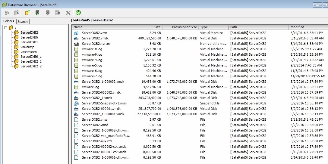

    Please provide a filelist of what you have inside the VMs directory.

    Thank you for your continued assistance continuum. Here is what is in the VM Folder:
    There are two volumes, ServerDXB2.vmdk and ServerDXB2_1.vmdk

    I think this should be easy to fix - unless the damage you have created by the misconfigured vmx and vmdks is already too severe.
    If possible call me via skype and let me do the repairs remotely - should take just a few minutes.
