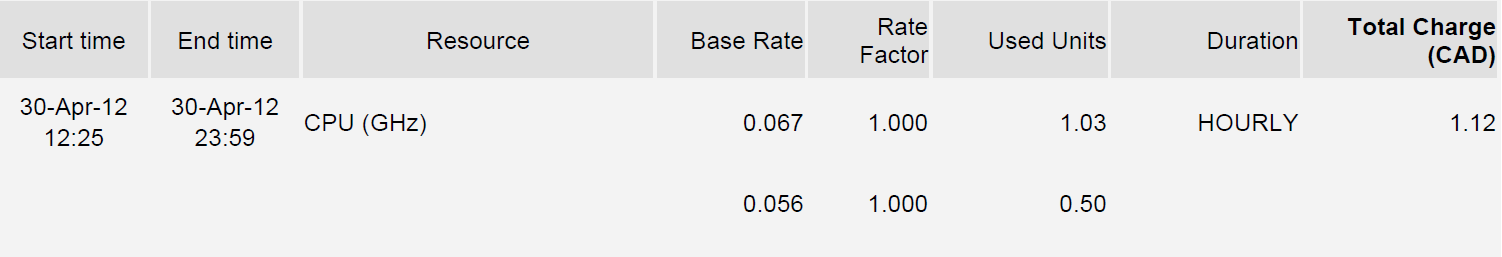

    The calculation that you show is correct from my tests. When you look at the pdf report for a case when there is overage you will see something like this:
    Above 0.056 is the base rate and 0.067 is the overage rate. The Used Units is actually an average rate (per hour) so the cost calculation in the above example is:
    TIME = (23:59 - 12:25) = 11.58 hrs
    COST = $0.056 * 0.5 * 11.58 + 0.067 * 1.03 * 11.58 = $1.12
    If you look at the detailed usage report you can see that the 1.03 is calculated as a sum of the usage above the allocation (0.5 above) over all the samples divided by the total time period (i.e., it is a weighted average of the overage usage over the time period indicated).

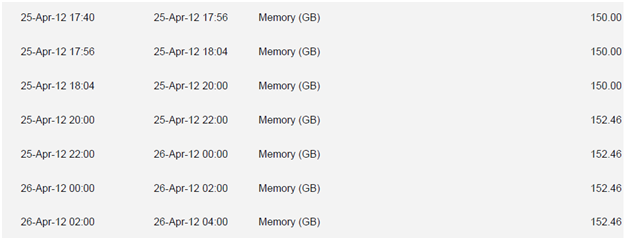

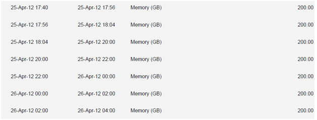

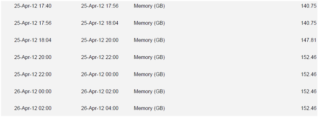

    Here are the results of my test.
    Set-up
    Billing Policy:
    cpu = max(usage,allocation);
    memory = max(allocation,usage);
    Cost model has overage charge for memory (note that the costs are artificial to easily see the behavior):
    Base rate - $18/hour
    Overage rate - $100/hour
    Procedure
    Run usage and cost reports on a folder in vCenter Hierarchy, so that allocation can be adjusted manually.
    Change the allocation from 0 to 150 to 200 GB and run the usage and cost reports for the above billing policy.
    Results
    Below are the usage samples for memory for a time that the memory was around 150 (some samples less, some more).
    Note that the first one shows the actual usage, since the allocation is set to 0. Second one, with allocation set to 150, shows some samples at 150 and others at the usage value. The last one with 200 shows all the samples at 200 (since actual usage was always < 200).
    Allocation not set:
    Allocation set to 150 GB:
    Allocation set to 200 GB:

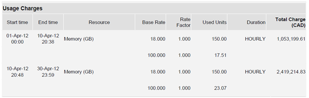

    Finally, here is the cost report segment for memory for the 150 case, when there is overage:
    This clearly shows the 150 base (allocated) and then overage for additional usage.
