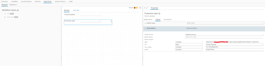

    I'm trying to utilise a vRO workflow as a resource action in v8.1 (patch 2). The workflow has 2 inputs, first is type VC:VirtualMachine, the second is a string that's populated via a drop-down that calls an action passing in the previously selected VM. This approach is working fine when the workflow is run directly in vRO. Workflow config here:

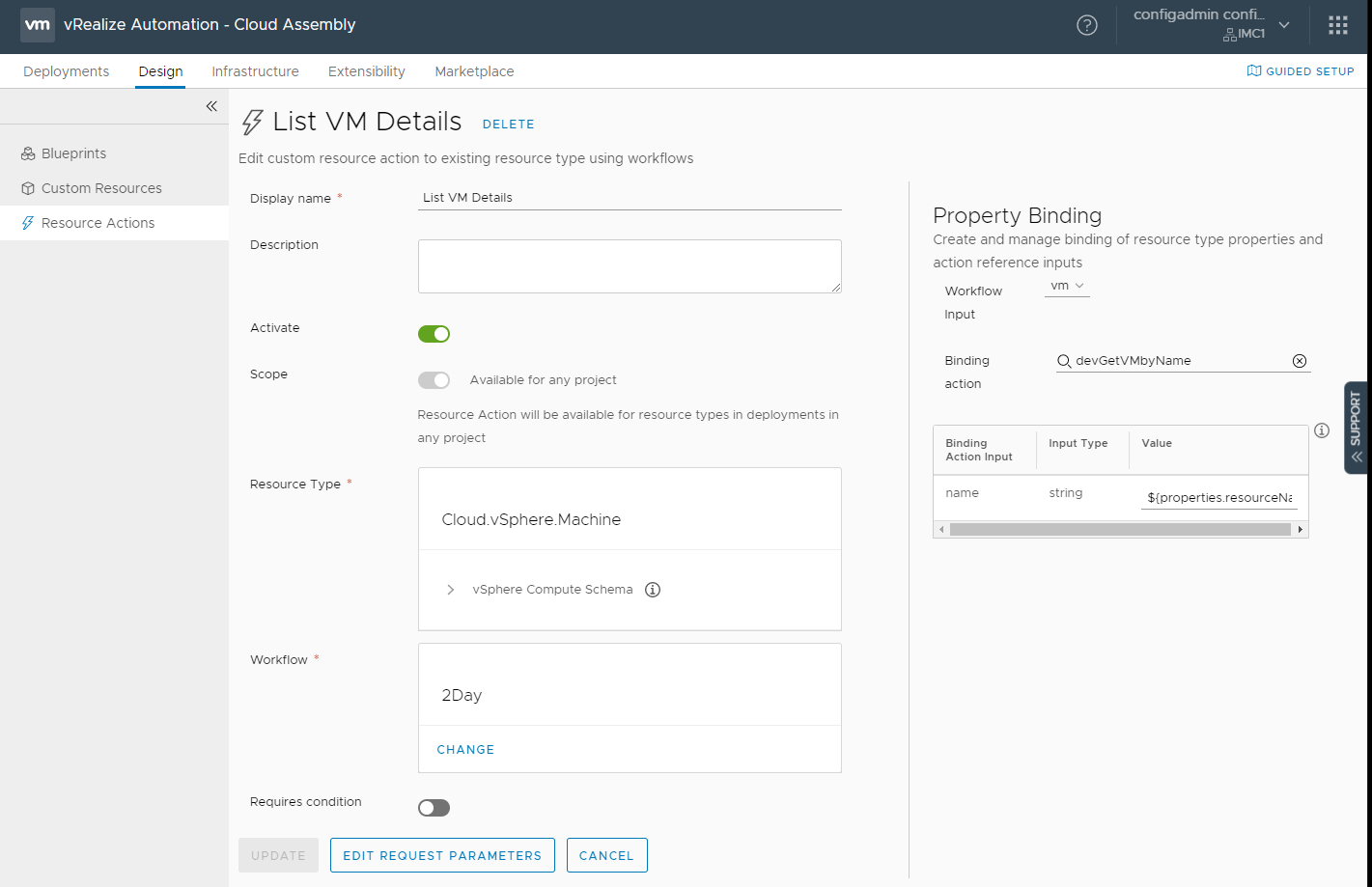

    I now need to get this workflow to work as a custom resource action. I'm following the logic used here to create the resource action: https://blogs.vmware.com/management/2020/08/introducing-custom-resources-and-resource-actions-in-vrealize-automation.html

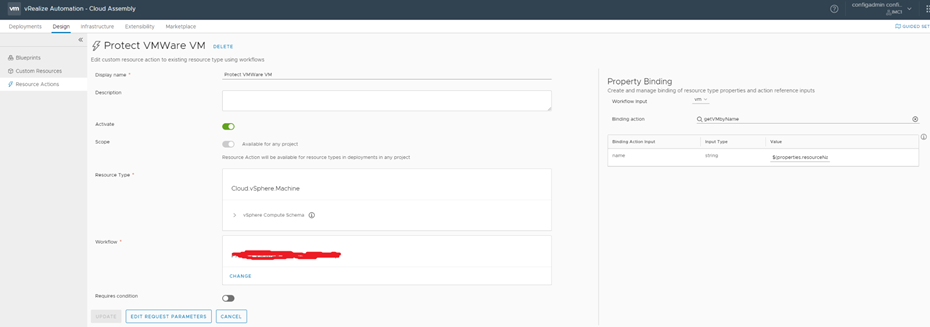

    So I've created the action to get the VC:VirtualMachine my name, tested in isolation it works fine, then I've configured my resource action:

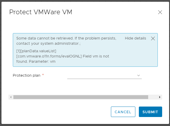

    When selecting a deployment the resource action appears as expected. When I run it I get:
    So basically the action that is called to populate the protection plan dropdown is not being supplied with the selected VM, which it requires to function.
    I checked out "Edit Request Parameters" for the resource action, and can see the ognl command that is failing
    So my question is how do I get the VM to be passed into the action? I've spent quite some time looking at this and can't see anything obvious, any help would be appreciated!

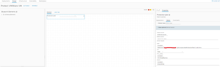

    When I configure the resource action as below:

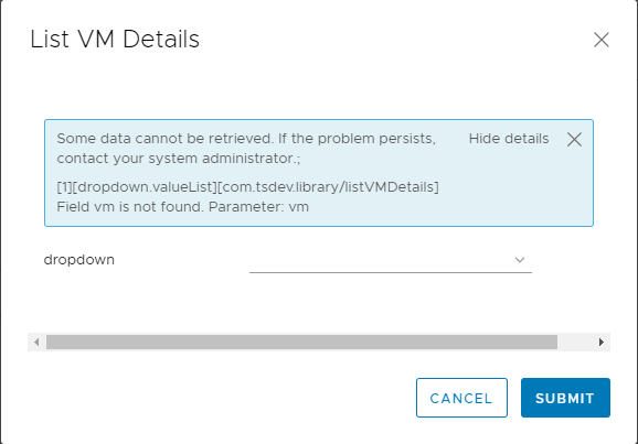

    I get this:
    I'm not sure if what I need to do is even possible, so if anyone has any ideas I would be grateful!

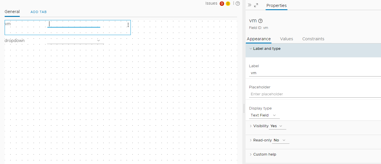

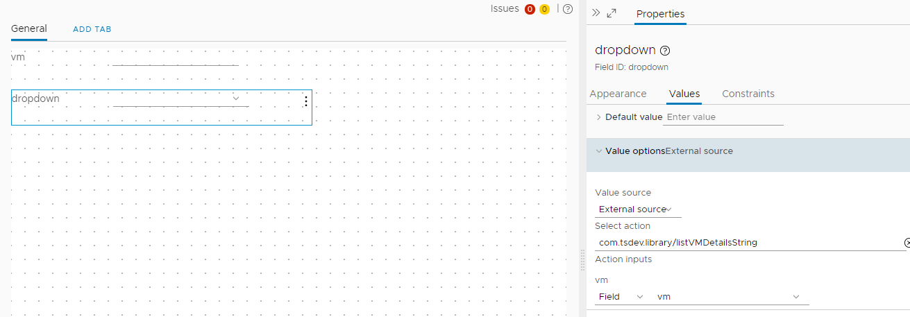

    I've put together another workflow "2Day String" (updated package attached) to have all string inputs. Now when I configure the resource action I can't get the value of the vm field to default to the name of the selected machine.
    Basically, I need the name of the selected machine to be passed into the actions that populate the other dropdowns on the form. so need a way to map ${properties.resourceName} to the vm field.
    If you could try on v8.1 for me that would be great.
    For reference here are screenshots of the config of each field:

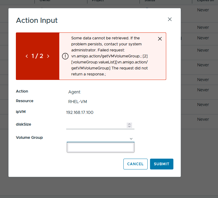

    Posted Feb 14, 2025 03:34 AM
    I got the same error in version 8.18.1, Resource Action 'Agent' doesn't return responses
