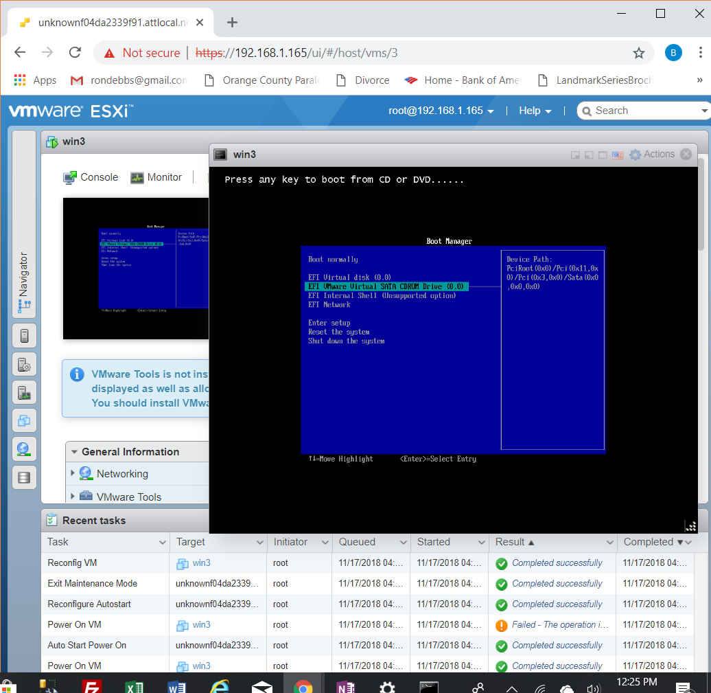

    I installed the esxi 6.7.0 on my Dell t5500.  I installed the client on my laptop and created datastore1\downloads.  I copied the 2016 eval ISO into \downloads.  While creating the first VM I used the browse button on cd/dvd and browsed to the ISO  file  and selected it.  After creating the VM I powered  it on hoping  it would boot from the ISO. I opened the  console  window  and  got  black screen that said  press any key to boot from CD or DVD...  Inside the black window there is  a blue  Boot Manager window.  I used the arrow key to move down to "EFI VMware Virtual SATA CDROM Drive (0.0). It still would not boot.
    I hit power > reset.  Black window comes up and says Attempting to start form  EFI virtual disk ... unsuccessful - virtual SATA CDROM unsuccessful.

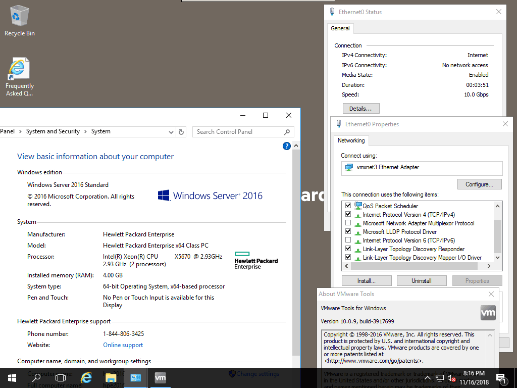

    E1000 for 2016 is not necessary since vmtools works fine on it, even the old version of vmxnet3 for 10.0.9:

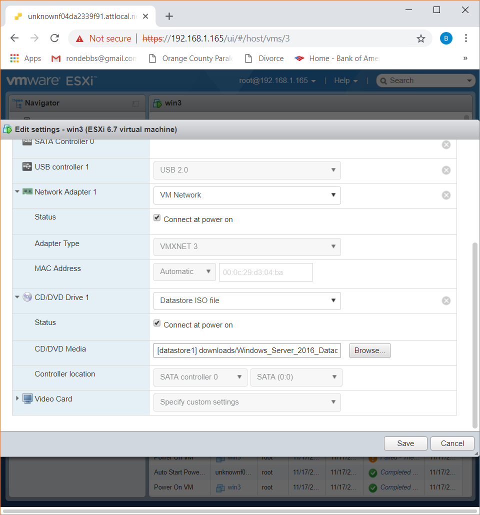

    So I changed my Network adapter on the vm from E1000 to VMXNET 3, same as Daves (didn't make any difference).  Also you can
    see my CD/DVD is pointing my Windows 16 ISO.  But still gets the same error (second screen print) in boot manager.  No matter how many times I
    select the SATA CD ROM drive it comes back with "Press any key to boot form CD or DVD.....".  Not sure what I need to change.

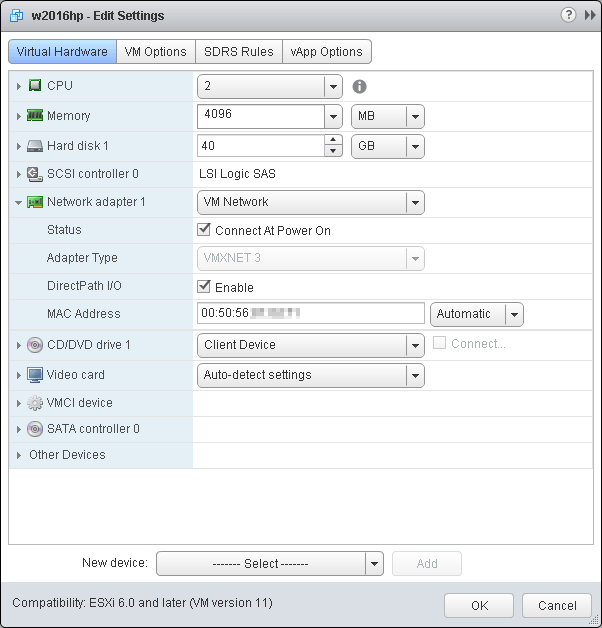

    You're not doing what I suggested in the last two paragraphs of my reply here to another one of your duplicate posts:
    Re: Home lab Internet access from new esxi host
    iso best to stay on your desktop computer so your CD/DVD drive 1 is Client Device.

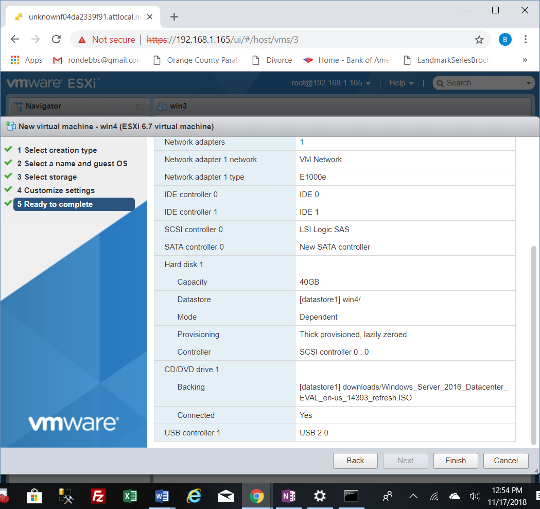

    I created another VM with same issue. The first screen shot shows the settings for the new win3 VM.  The second shows what happens when I try to power on/boot.

    Hopefully from the screen shot you can see how the CD/DVD  is pointing to the ISO.
