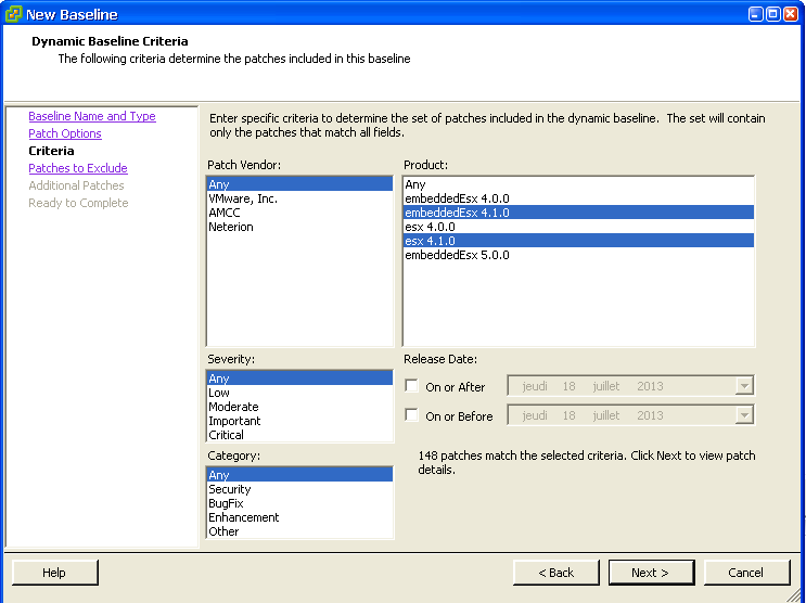

  • 18.  RE: Could not power on VM : Invalid metadata - storage
    Posted Jul 18, 2013 08:56 AM
    Hi,
    So you need to have vCenter update manager installed.
    • Then go to update manager administration and create a new baseline , type a name and select host patch :
    • Select dynamic patch option and select product as needed. (Here in Severity , select critical, if you need only critical patch).
    • Then leave by default and click on finish.
    • After you need to attach your baseline to your cluster. So select your cluster, go to update manager tab and click on "Attach" and select your baseline previously created.-
    • Right click on your cluster and click on "Scan for update".
    • Select a host, put it in maintenance mode. Then right click and remediate.
    Et voila :smileywink:
    Regards,
    Julien.
