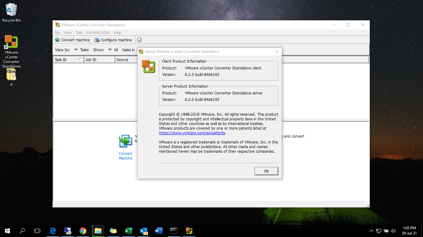

    Hi thanks for the response am using this version

    try to install the converter-agent manually on the source computer - its located in the install folder of the converter named vmware-converter.agent.exe
