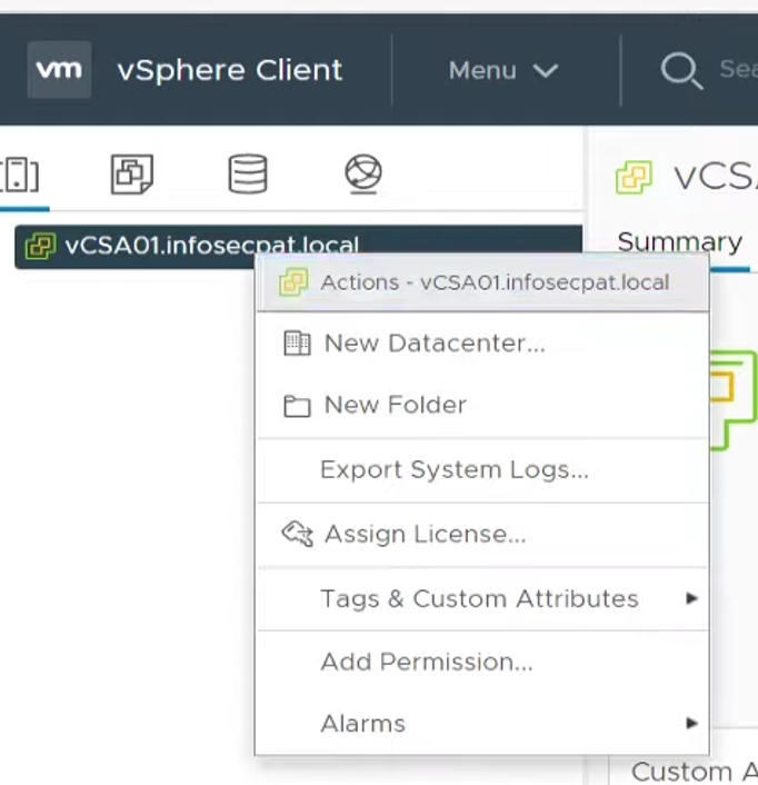

  • 6.  RE: Connecting an existing ESXi to a Hosted vCenter
    Posted Jun 21, 2022 01:04 PM
    Yeah, don't have a datacenter.

  • 7.  RE: Connecting an existing ESXi to a Hosted vCenter
    Posted Jun 21, 2022 01:18 PM
    You have to start with a Datacenter - that is the "root" object for your inventory: https://docs.vmware.com/en/VMware-vSphere/7.0/com.vmware.vsphere.vcenterhost.doc/GUID-7FDFBDBE-F8AC-4D00-AE5E-3F14D7472FAF.html

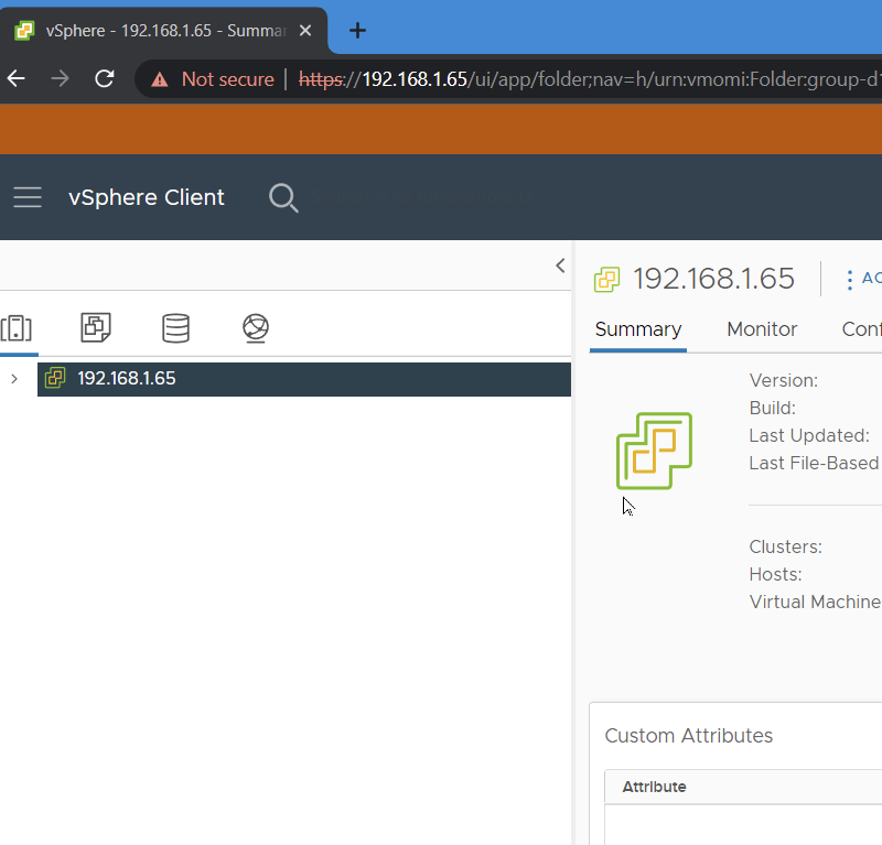

  • 14.  RE: Connecting an existing ESXi to a Hosted vCenter
    Posted Jun 22, 2022 01:04 PM
    Never mind, port 443.
  • 15.  RE: Connecting an existing ESXi to a Hosted vCenter
    Posted Jun 22, 2022 01:08 PM
    You need to point your web browser at the vCenter Server FQDN/IP in order to create the datacenter and add the ESXi host (even though the vCenter Server itself is a VM sitting on the ESXi host)

  • 16.  RE: Connecting an existing ESXi to a Hosted vCenter
  • 17.  RE: Connecting an existing ESXi to a Hosted vCenter
    Posted Jun 22, 2022 01:33 PM
    And solved.
    Thanks to a Facebook group of homelabbers.
  • 18.  RE: Connecting an existing ESXi to a Hosted vCenter
    Posted Jun 22, 2022 01:56 PM
    And now i have a connected host, my ESXi hypervisor.
