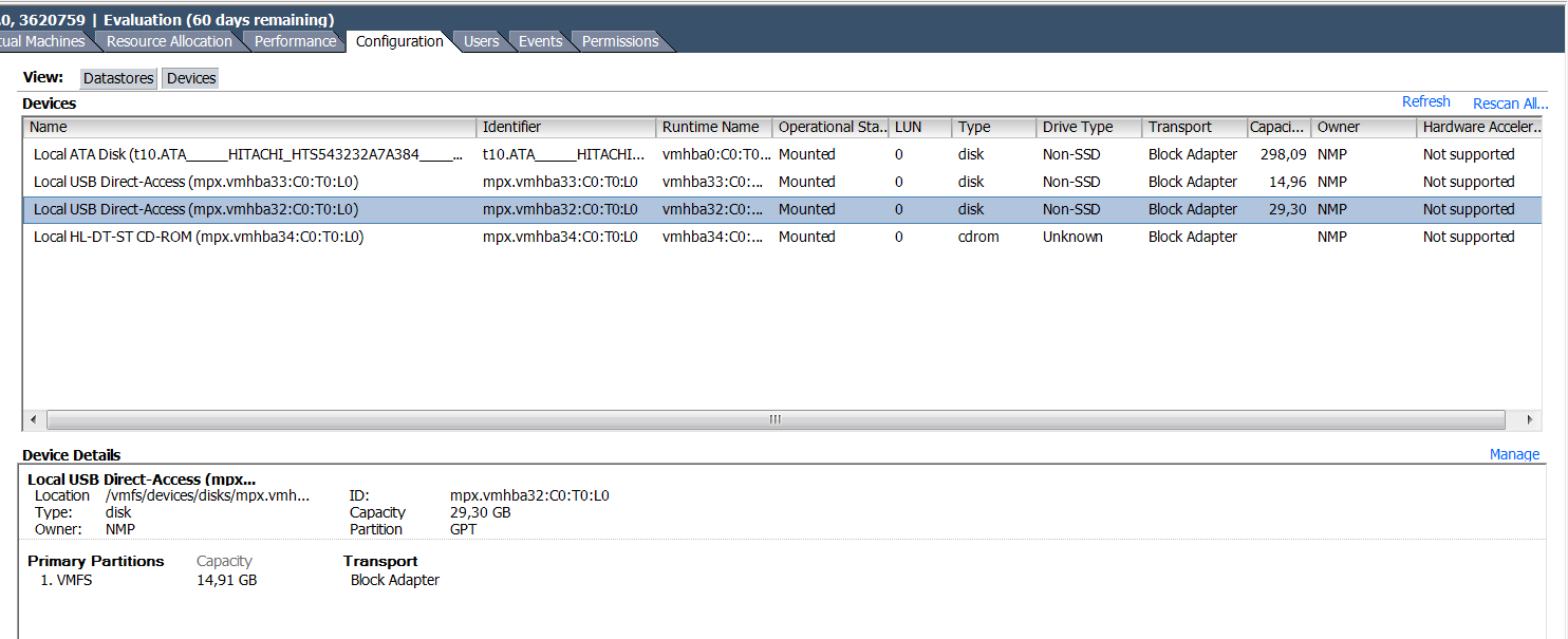

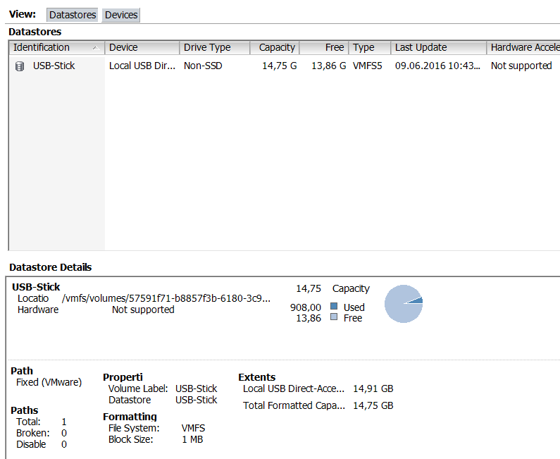

    I know this is an old post but I came across it in my search for the same thing. It is definitely possible in ESXi 6.0.0. There is a great write up at http://www.virten.net/2015/10/usb-devices-as-vmfs-datastore-in-vsphere-esxi-6-0/‌ . I just finished performing it and confirm it works.
  • 16.  RE: Connect an usb disk to an esxi and present the disk as datastore
    Posted Jun 09, 2016 09:02 AM
    I tried following the article, i was able to mount the usb drive but can not see it in the data stores.
    I did exactly similar steps, and my usb drive can be seen in the devices section on vsphere client (as mounted ). However, I can not see it under the datastores section.
    it only shows the other usb drive in datastores section, which has the esxi host installed on it !
    When i try to add a new datastore it shows up the option of local hard disk, which i do not want to touch. I want to run my VM on this external usb drive that can not be seen as datastore on vsphere client.
    Can you suggest something here ? I did not get any errors while mounting the usb drive on esxi host as per steps mentioned above
