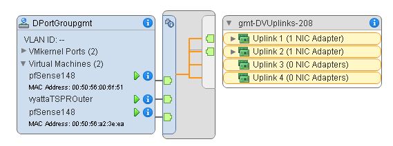

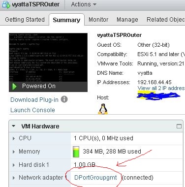

    No, I think it's a vDS issue. As you can see in Capture1 and Capture2, both VM's network adapter 1, is on the same network (the same distributed port group). There are no VLANs and the IPs are in network 192.168.44.0/24 . vyatta is having 192.168.44.44/24 and pfSense 192.168.44.144/24, so they should work through the distributed switch. And actually this is the purpse of having distributed switch. Otherwise I have managed to make them talk each other by setting up VPN tunnel etc. But I do not want such a complex thing, I just want to use the distributed switch. The same deployment but when the two VMs are on the same host is working, when the two VMs are in different ESXi hosts, ping does not work, so I believe this relates to vds.
