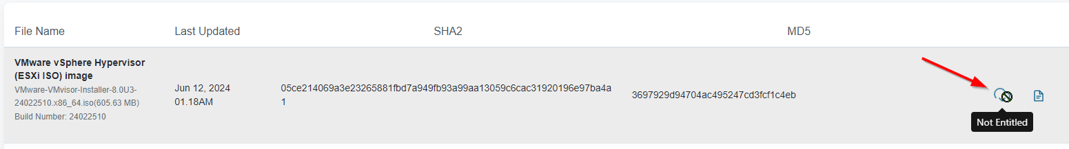

    so after waiting a while,
    I'm trying to check entitlements and downloads and our ability to navigate the site in general.
    I have our contract number, account numbers and our perpetual support end date of 2025-11-13.
    I can't find any of our entitlements loaded - just a lot of other unrelated contracts for other divisions within our group that have no bearing on my specific contract.
    I think, no problem, I'll try and open up a support case, but then the SSO loop begins and I end up with a pop up saying;
    "Error: We could not process your request, please try later"
    I'm sorry but this is unacceptable and an absolute abomination compared to the previous VMware site.
    I'm really disappointed that my first interaction with the Broadcom support site has failed and this has a direct bearing on how we'll be approaching our renewal in November 2025.

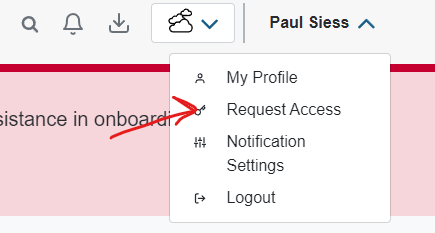

    I had a ticket open for over a month with no movement to resolve access to our primary Site ID.
    To quickly resolve, go to the Support portal, open the Virtual Chat in the lower right corner.
    Start a new conversation, select: vmware > type a query > "contact us" > Report a New Case > Customer Care/ Licensing > Chat with an Agent
    They fixed my Site ID access pretty quickly and I have my entitlements again.

    @dessimus Did you know your site ID beforehand?
  • 20.  RE: Come on Broadcom - the support portal is not acceptable for enterprise customers
    Posted Jun 27, 2024 09:13 AM
    No, but I had my VMware Account IDs from the VMware licensing portal prior to the migration.
  • 21.  RE: Come on Broadcom - the support portal is not acceptable for enterprise customers
    Posted Jun 27, 2024 09:23 AM
    Ok thanks.  I'll give it a try next week.
  • 22.  RE: Come on Broadcom - the support portal is not acceptable for enterprise customers
    Posted Jun 27, 2024 12:51 PM
    This worked. About 10 minutes from start to agent, and then 10 more minutes until I could access downloads. I knew VMware account no. and got new Site ID via steps below. Not sure if he needed either or both.
    He needed me to have already submitted an access request to the Site ID, which he then went in and approved.
    I found my Site ID under My Profile > Build Your Profile > Yes, I want to Build My Profile > I am Interested in Broadcom Software > Submit > Site ID is noted on screen.
    From there, back to Support Portal, click on your name, then Request Access. Submit new request with that Site ID. Then a case is opened, that the chat agent can access and approve.
    Wolken SSO login is still broken and looping when trying to open the access request case.
    Good luck!

  • 25.  RE: Come on Broadcom - the support portal is not acceptable for enterprise customers
    Posted Jul 08, 2024 09:43 AM
    THANK YOU!  This worked for me.  I already had access to one site ID (albeit, not my site, not my company) so I used that to open the support request.
    From there, I opened a chat, got a live person, and told the agent that I needed to find my site IDs.  The agent asked for the email address associate with my VMware products.  From there, he sent me 4 site IDs.
    I then used the Request Access link in the profile dropdown.
    I added each of the site IDs provided by the agent.  Within 48 hours, I had access to all of my licenses.
    I hope this helps others.
