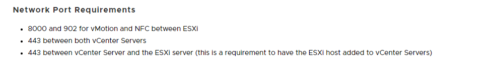

    The TCP port required for Across vCenter Migration are:
    • 8000 and 902 for vMotion and NFC between ESXi
    • 443 between both vCenter Servers
    • 443 between vCenter Server and the ESXi server (this is a requirement to have the ESXi host added to vCenter Servers)

    ok so cold migration still uses TCP/8000 as this is what I could not see in documentation?

    There are various references to the 8000 tcp port
    The original product documentation in the requirements:
    https://flings.vmware.com/cross-vcenter-workload-migration-utility#requirements
    reports using the KB requirements
    https://kb.vmware.com/s/article/2106952
    where it is indicated
    also on this site it is indicated
    https://www.altaro.com/vmware/cross-vcenter-vmotion/

    Yes confirm that cold migration worked withTCP/8000 and TCP/902 between the Source/Destination Hosts
